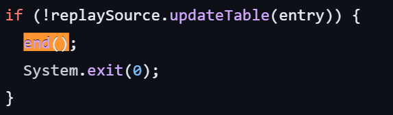

yeah, I was thinking of that too; however, I realized this:
When end() is called, Logger.running becomes false; however, I can’t exactly track when that happens without calling updateTable another time, which might mess up replay.
If the logger is not currently running, i’m afraid that accidentally pushing data to a log table might throw an exception or mess something up.
If the logger is not running, any calls to processInputs
or recordOutput
will exit without changing anything. The snippet you showed it called at the end of log replay (when the replay source has no more data), and causes the robot code to exit. What are you trying to accomplish that requires starting and stopping the logger outside of robotInit
I’m not trying to start or stop the logger; I just need to double check that it is running.
Since that end() function is called during replay and the robot code is exited immediately afterwards, I think my problem here is mostly solved(I just keep track of the logger’s state in the robot class too).
I was trying to write a generic AdvantageKitLoggable interface that allows custom stuff to be pushed and pulled from log(with a LogTable and category string passed into the functions).
I wanted to add a recordAsOutput() function that places the outputs of the class into the RealOutputs/ReplayOutputs category(essentially mimmicking Logger.recordOutput(), but for custom classes). However, I was afraid that by calling table.put() when the running static variable of logger was false, something might go wrong; thus, I wanted to make sure that the logger was running before doing that.
