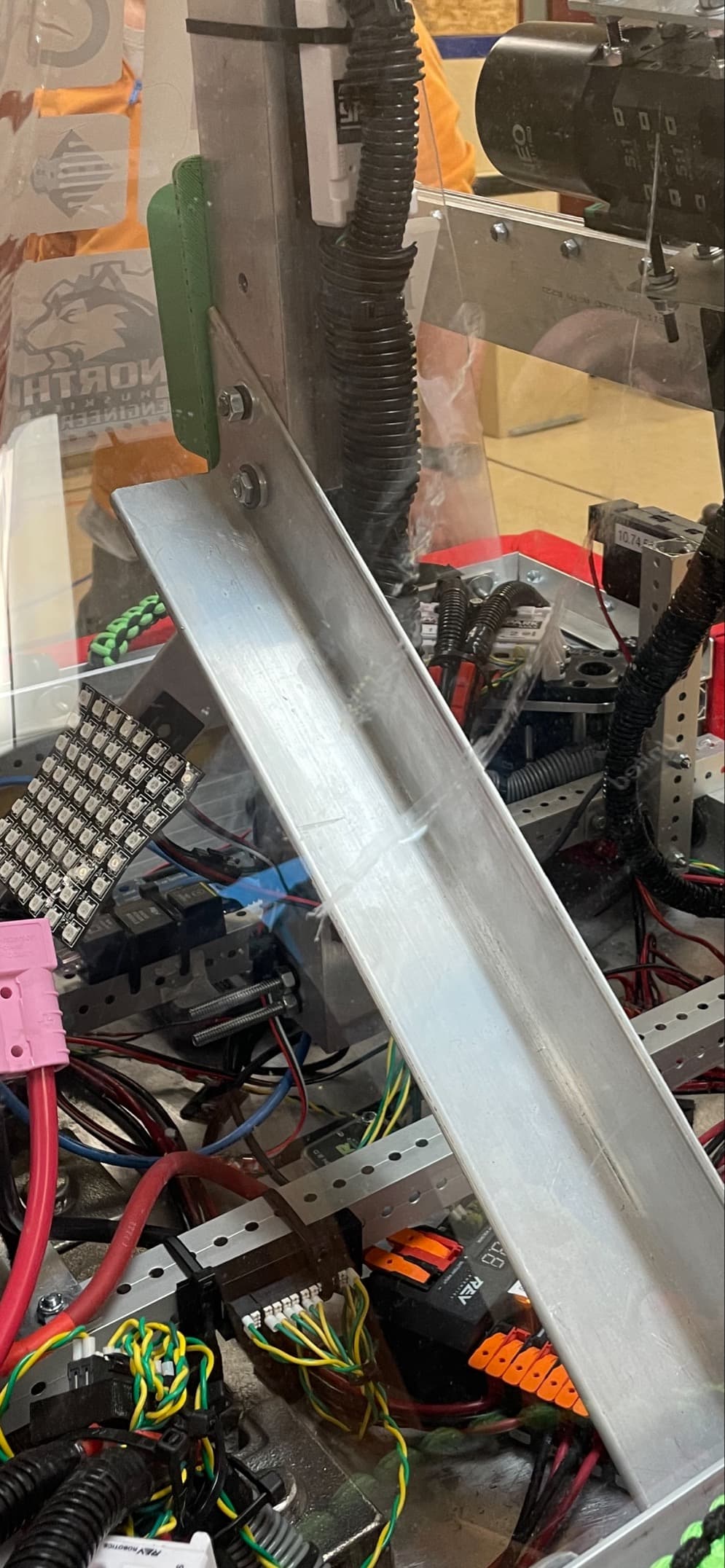

I’m a mentor for 7454 and was drive team coach that match. The directive was to remove all game pieces from the open field. You can see us sweeping them out prior to the hit. We went after the piece the same time 4272 was going for it and their intake hit our pyramid driving it up the side and flipping it. I’m fairly certain bumpers never touched.
I really hate that we were responsible for another robot going over. That is not something that any team wants to experience. We apologized to 4272. It messes with you. The driver felt horrible and did not perform the rest of the match or the rest of the day. We felt like outcasts for being “that team”. After watching the video, I’m pretty certain there was nothing we could have done to prevent this.
Here are the wheel marks from the intake left on the lexan. It drove right up our side.
