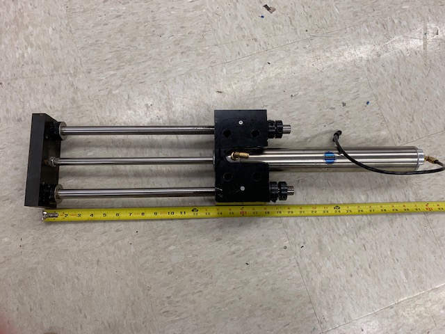

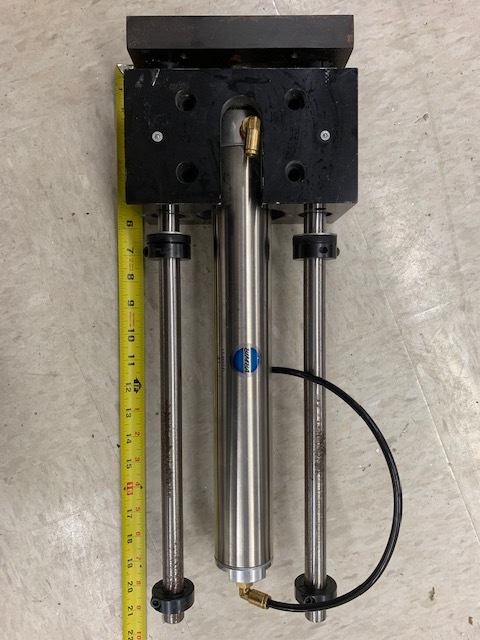

Is this cylinder legal?
It’s a 2-inch bore with a 12-inch stroke. It accepts the tubing that came with the kit and operates fine with the compressor and solenoid valves. I ordered some 2-inch, 18-stroke cylinders with our voucher from Bimba, but I don’t think they will be in before bag day. This one was donated to us. The writing on the cylinder under the Bimba logo is LT-3112-D and underneath that is &*].
If the cylinder is legal, is the mount it’s attached to legal? Provided that it does not make our bot weigh too much.
IMG_1087
IMG_1088
IMG_1090
IMG_1086
IMG_1093
Edited to add more pictures.
All legal.
Restrictions are just that it be rated appropriately, take 1/4 tubing, and it remain unmodified.

Outside of what has already been discussed, one possible issue in regards to the mounting guide would be the price of that unit. Similar (at least in spirit) industrial guide units for cylinders can get pretty pricey.
If the donor has a BOM or drawings for the guide unit, it may be possible to use it directly, or create a cheaper and less “industrial” assembly better suited for FRC loads.
What is the fair market value of it? It needs to be <$500 per R13.

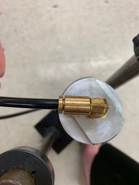

On a side note, do the rules not require the fittings to be push-connect style? I could have sworn that was a rule but I cannot find it. I ask because this photo appears to show a different style.
Air solenoid valves have a maximum fitting size, they must have 1/8 NPT (or smaller) and all tubing must be 1/4 or smaller,
But cylinders don’t have a max fitting size. Cylinders ‘take’ 1/8 NPT or 1/4 NPT. Or Metric in some cases. Cylinders bigger than 1-1/2 inches bore actually have 1/4NPT fittings, so may need bushings to install a 1/4 tube fitting in them.
When you say “take 1/4 tubing” you mean “can be fitted to take 1/4” tubing"

If the block/bearing assembly a COTS item you’ll need to show it’s cost.
If the block/bearing assembly was custom made by someone (the donor?) outside of this year’s build cycle then I think it might be illegal.

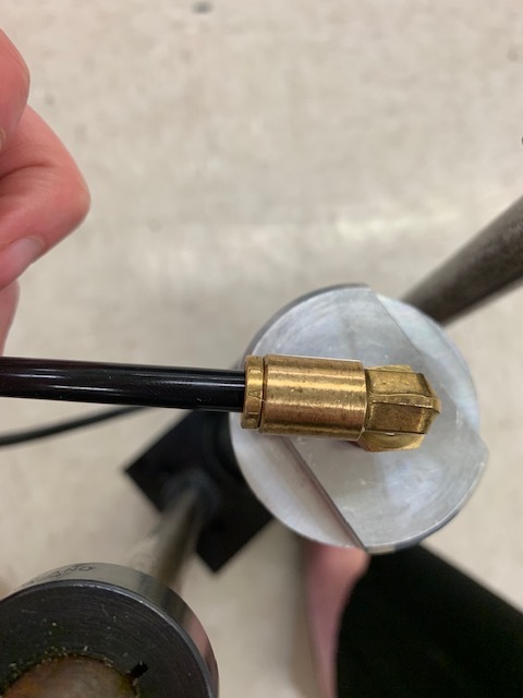

Can you see how they work any better in these pics? They operate like all the other ones, just a metal lip instead of a plastic one. You push the tubing in, and in order to remove them you push the metal lip down. “Like a chinese finger trap” as one of my team said.
@Christopher149 had a somewhat tangential concern about fitting requirements, which is what I was addressing with my statement about port sizing. Sorry if this caused confusion.
What you have on that cylinder are likely similar to the “quick connects” Christopher was referring to, but yours just happen to be metal and have a protrusion in the middle of them that most plastic varieties don’t have. All push-to-connect tube fittings I’ve seen operate in a similar way.

In the end, this is very likely a legal cylinder. To determine if the guide unit is legal, please take into consideration what James and myself have brought up in terms of price and when it was assembled.
Looking at similar models on the Bimba site I think the thruster it’s attached to far exceeds the $500 limit. Thanks for the heads-up!
I don’t think the guide unit is legal due to what I’m seeing on the Bimba site. Wow these are pricey. https://www.bimba.com/Products-and-Cad/Actuators/Inch/Guided/Standard-Load/Composite-Bearing-Thruster
It’s enormously heavy anyway, so I think I’d like to see my team rig something up.
