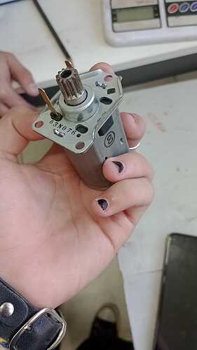

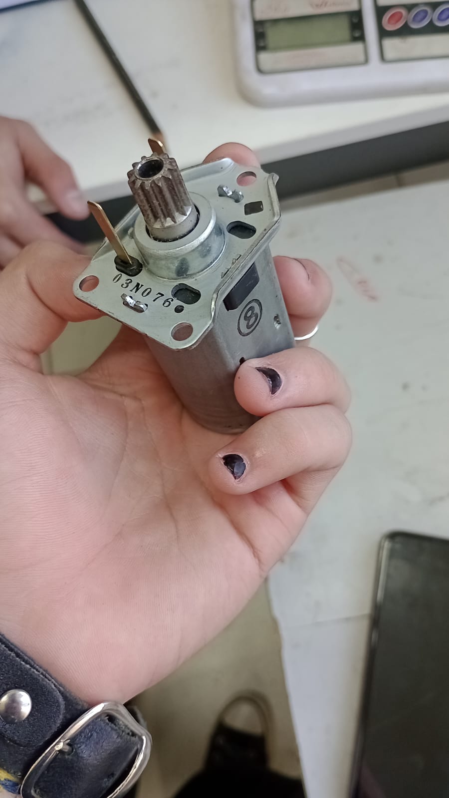

hello I’m from the Etechnology team #8267 and we have an engine that we can’t find anywhere, we want to know if it’s allowed by the FIRST rules, we searched by serial number and no result
engine photos:
It’s a Denso Throttle motor!. While legal, they aren’t the best option on the market currently.
Yes, you’ll see it called a “throttle motor”. They came in the KOP for many years (might still, haven’t seen the KOP in a few years now). If you look in the manual at rule R501, it’s legal under the category “Current/former KOP automotive motors”.
Though I’ll agree they’re not really good for anything in FRC. At 18 Watts they’re going to struggle to move just about anything.

To put it in perspective, FIRST has provided motor specs in the past (Google turned up 2016’s here). The Denso Throttle Motor is an 18W motor with a free speed of 5300 RPM and a stall torque of 18.4 oz-in. Can you make that work with an appropriate gear reduction, meeting your force and speed requirements for the mechanism?

hello, previously in my last post I talked about this engine, does anyone know what its torque would be? we know that it is a KOP engine, (which although it is not very biom it is what we have for an adequate weight)
Product Specifications:
Voltage 12V DC
Free Speed 5300 RPM
Free Current 0.4A
Stall Torque 18 oz-in
Stall Current 7A
Max Power 18 W
Length 3.4 in
Weight (lbs) 0.5
Wow, I never looked at the specs that carefully before… at 18 oz-in, or 0.127 N-m, it’s basically weaker than any other FIRST-legal motor besides Servos. It works out to around 5% the torque (at the same RPM) as a CIM motor. Even FTC motors outperform these things. :joy:
