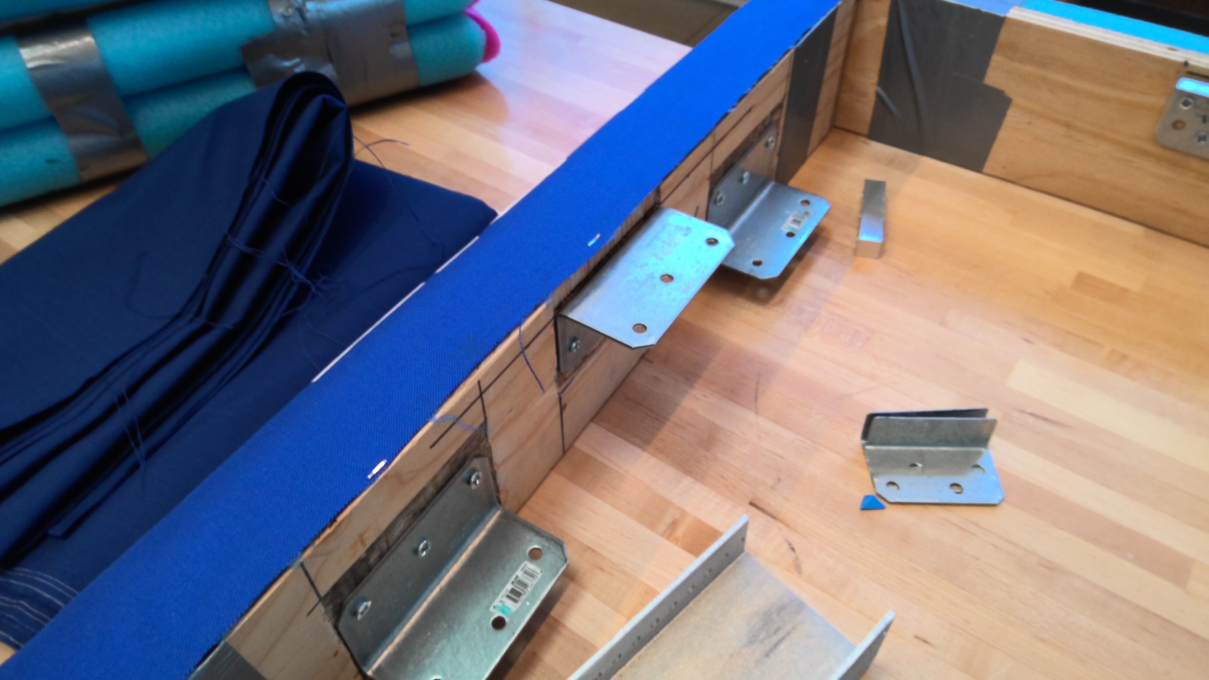

Is this illegal?
Just wanted to get some feedback from the general first community.
is the way that the fabric covering the bumper illegal?
I would probably put some more staples in there, to make sure it doesn’t pull out.
The rule you’re looking for is R408 part D, specifically:
The cloth must completely enclose all exterior surfaces of the wood and pool noodle
material when the BUMPER is installed on the ROBOT. The fabric covering the BUMPERS
must be solid in color.
When installed on the robot, exterior bumper surfaces are the top, bottom, and outside (pool noodle side). The inside, where it mounts to the robot, is not an exterior surface and does not need to be covered by fabric.
where the top bracket is there are sometimes bits of wood showing but only once and a while. Is that also still Illegal?
In the instances in which you’re describing, the cloth would not “completely enclose all exterior surfaces of the wood”. This would probably be up to the local inspector on how lenient they are.
I’d err on the safer side and look at A) more staples to ensure the cover stays on the bumper near the edge and B) some hardware store aluminum angle over the fabric at the edge per R408 part E to prevent the fabric from showing the wood. (Figure 9-7)
We had a partner get disabled on the field for a small sliver of their bumper wood showing last weekend. I’d save yourselves any future headaches and just rewrap them. Even if you pass inspection you could potential have an intake pull a few staples here, small effort now saves a big headache later.

Here’s what I would do, if you have an event this week, double the amount of staples and then cover the staples in blue and red gaff tape. If you don’t have an event this week redo the fabric with it wrapped to the back of the wood, as others have said it’s just not worth the risk.
Definitely need to finish the stapling job, but other than that it is perfectly fine, we’ve ran bumpers stapled like that for years and with the proper amount of staples have never had them come undone. As John stated there is no rule that requires covering the side of the wood that faces the robot.

On the opening picture, concur on more staples or an aluminum clamp, but otherwise good.
I can’t really say without seeing it, and frankly nothing I could say about it’s legality is binding for your event - the LRI at the event would have the final say. The rule is pretty clear and easy to apply strictly, but I know many LRI’s are being a little more lax this year since every team is pretty much rookies again. Without seeing it, I’d say your odds of being legal are no better than a coin flip.
In a situation like this, as a mentor, I would err on the side of a strict reading of the rule - I hate having to solve a problem at the event if a little work in the shop can prevent it. If you have the weight for it, adding aluminum angle to the top (and bottom if needed) is your best bet to meet a strict definition of legal, short of re-wrapping with new fabric. See R408 part E and figure 9-7 for details.

I know this isn’t an answer to your question, but I just have to mention it. We used wood screws to attach our brackets to our bumpers and when we played defense they ripped right out. It looks like you’re using wood screws there, so just make sure they are long, wide, and super strong or use screws with bolts backing them instead. Our team learned this the hard way XD
The most important factors are that the plywood is of a decent quality (not the cheapest available) and the screws are long enough.
The higher quality plywood has more layers of thinner veneer and the veneer is made from better quality wood with fewer voids and defects.
The screws should belong enough to go almost all the way through the whole thickness of the plywood, including the thickness of the brackets.
One way to significantly increase the pullout strength of the screws is to saturate the plywood with runny superglue/cyanoacrylate. The gel types will tend to just sit on the surface and will not penetrate into the wood the way the runny type does.
For the OP, @Nich2752 , they should remove the screws one at a time then drip several drops of runny superglue into each hole. Wait a minute or two or spray accelerator into the hole. Reinstall the screw. It should take a lot more effort like screwing into a piece of solid hardwood. If not, remove the screw and apply more superglue. Be sure to wear latex or nitrile gloves on both hands so one doesn’t “become one with the robot” like certain mentors have :wink:

Yes, the newer bumper weight limits make it tough to have full length bumpers and aluminum angle top and bottom unfortunately. Last year and this one we’ve had to omit one piece of the angle, which is a break from our traditional construction.
Put countersunk holes in the back of the angle (so screws will be going into the plywood through your bumper material, which wraps around the back of the plywood) at about 3 or 4 inch intervals and use a nice solid countersunk screw like this https://www.mcmaster.com/90610A148 and you should have no problem with exposed wood on top of plywood or fabric getting ripped off. However, make sure you have enough fabric to begin with!

From a practical perspective, I like the advice Peyton, Dave and others gave: fix it now because there isn’t much upside to ignoring what appears to technically be a violation (albeit one that would not diminish the quality of the competition, were it ignored). Why be at the mercy of others when you can control your own destiny?
