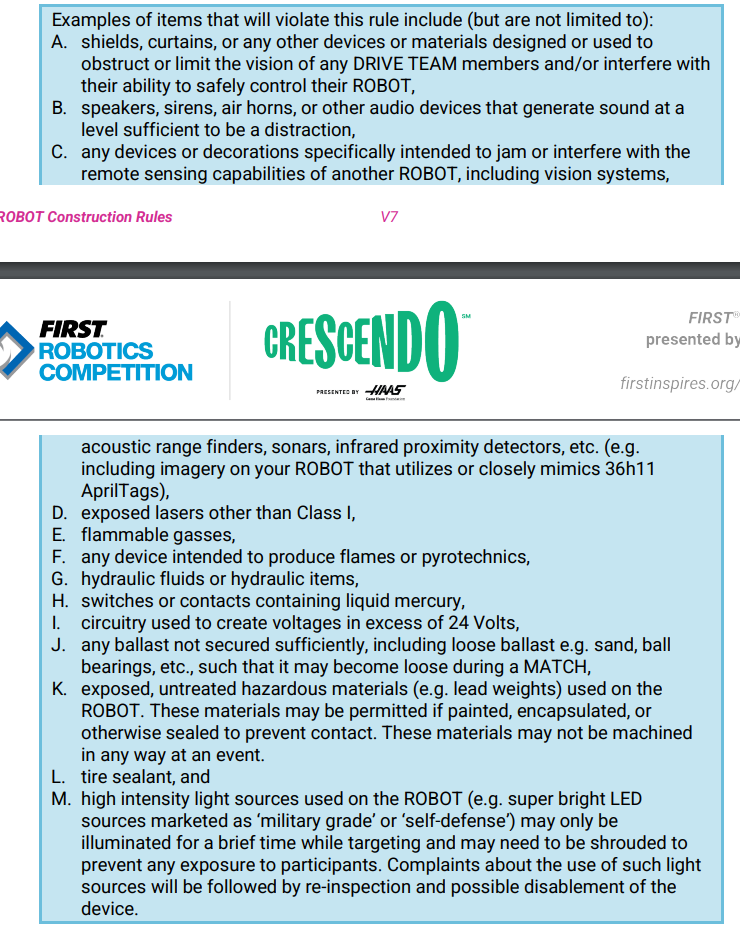

You cannot. R203, Blue Box example C.
R203 *General safety. ROBOT parts shall not be made from hazardous materials, be unsafe, cause an unsafe
condition, or interfere with the operation of other ROBOTS.
Examples of items that will violate this rule include (but are not limited to):
C. any devices or decorations specifically intended to jam or interfere with the
remote sensing capabilities of another ROBOT, including vision systems, acoustic range finders, sonars, infrared proximity detectors, etc. (e.g.
including imagery on your ROBOT that utilizes or closely mimics 36h11
AprilTags)
In re-reading that rule, considering some teams are not just using april tags and are using vision in general, would any intentional visual obstruction now start falling afoul of this rule as it interferes with a robots remote sensing capabilities? If so where is the line where robot design crosses into intentional interference ?

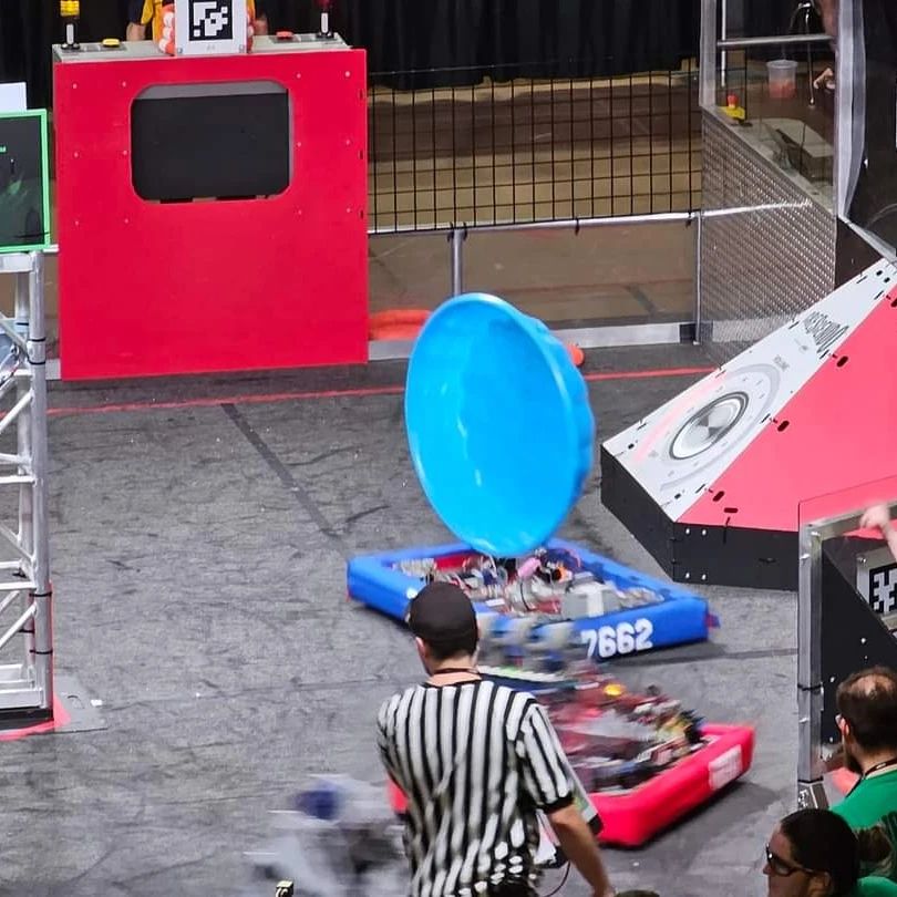

Basically when the head ref thinks you’re being malicious.
Blocking camera FOV = always legal
Imitating a target = never legal
Part of your robot happens to look like a target = exasperated head ref.
It is completely legal for your robot to wear a cardboard box hat to reach the maximum robot size, for any reason. Could even sell billboard space. maybe a sponsor’s logo looks like a vision target

Every team should be perfectly allowed to build whatever they want within their build volume. (that fits the other rules)
You should not be obligated to make tags visible because you built a tall robot.
