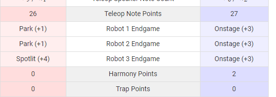

is it possible to tell on tba if ensemble is given because of penalties rather then being earned?
TBA should have a breakdown of which robot did which—if it doesn’t add up, it must’ve been a foul.
Yes, but you have to look at the results from individual matches. For example you can see:
The blue team had 3 climbers plus 2 harmony points. If you don’t see points adding up to 10 (and 2 onstage), you can assume it is from penalty.
You can check the whole event using the TBA API, as G424s are recorded in the data FIRST makes available to teams.
