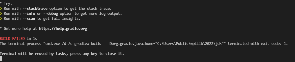

Issue being unable to build code
Hey all, I’m having an issue where my code will not build and gives an error out that I do not understand/cannot fix. This is even after a fresh install on the laptop I’m using. Hope someone can help me out and see where I went wrong/how I can fix this issue.
Can’t help you out without seeing the actual stack trace.
The real error is up higher in the message.
As @NewtonCrosby mentioned, we need to see the actual error.
Also, be sure to read this page thoroughly: Reading Stacktraces — FIRST Robotics Competition documentation
Figured out the error, didn’t realize there was more than just the error exit code. Thanks all!
