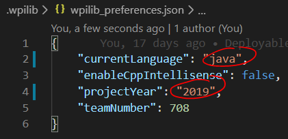

My team is also having this issue. The imported looks to have worked with our code we ran last year but nothing we were working on in the off-season. What ended up working was adding “2019” and “java” to the wpilib_preferences.json, they were originally in there as “none”, in the “.wpilib” folder. Try that first. image If that doesn’t work, It also looks like there is a difference between our launch.json file and I was missing a settings.json file from the “.vscode” folder. I don’t actually know what I am doing so I replaced the launch.json file and added the settings.json from last years code. Everything is converted and more importantly everything still build once I added the 3rd party libraries back in.
