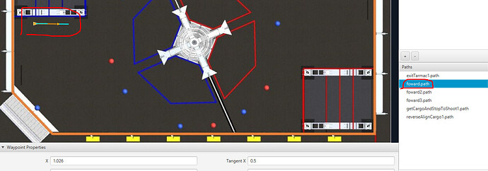

We started to make an “official” autonomous for competition, and the multiple paths worked. So, we tried to run many times the same autonomous, like 5 times, and the robot did the same track 4 times. In the last attempt, we noticed a issue. On the last attempt, we just renamed a file, and clicked to “Build Path”. We deployed our code, and expected to run successfully as the other 4 attempts. But, we noticed that something occured. Our robot had a very different trajectory than before (We did not change anything on the trajectory in pathweaver). For example, it tried run in reverse and straight, but it was reverse with a curve. Looks like the left side motors receives more velocity.
Since 2 days ago we noticed that sometimes our autonomous robot starts to bug the trajectory. So, we have to delete all the current pathweaver configs folder on our root project and then start again a clean pathweaver project. Sometimes it works, and sometimes no.
We also tested all our sensors, like encoders, and the electric system seems ok. We tested the robot in teleoperated mode, and the robot runs straight, the encoders receives the right values.
When a path is not running ok, I noticed that pathweaver projects .json has a very strange info on the final of trajectory
this print is for foward.path
this print is for foward.wpilib.json
the curvature attribute has an bizarre value. Maybe it shouldn`t have this value.
