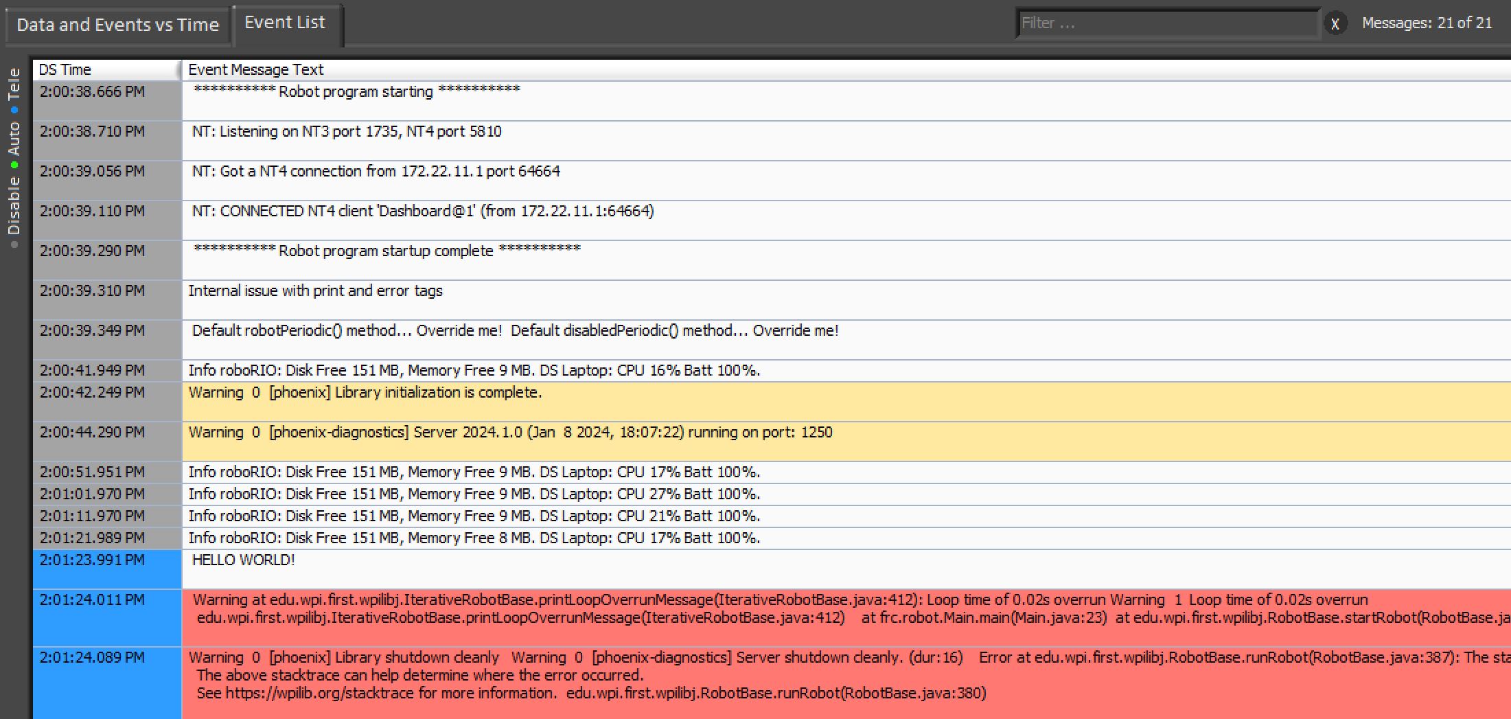

I am a team mentor helping out with some programming. I have been trying to code motor controllers, encoders and an ADIS16448 on our testbed control system. Currently, I’m just trying to get the Gyro’s Angle value to show up on the SmartDashboard. I can get other values (like encoders and text etc) but when I try use the .getAngle() function in the code, it will deploy but as soon as I try to enable the code, it will crash and flash “no robot code”. i’ve tried other functions of they Gyro with the same error. I even tried doing a System.out.println and the same thing happens only when I try to send the angle value.
Here are the 2 lines of code that will crash the roborio once I hit enable:
SmartDashboard.putNumber(“Angle”, m_imu.getAngle());
System.out.println("Angle: " + m_imu.getAngle());
Below is the code (which was built from some of the sample code provided). It’s rather messy with a LOT of commented out code but it’s just for our testbed to get the Gyro working.

Here is a snapshot of the drivestation log
Any help would be greatly appreciated!!
This is your problem–it’s never initialized, so you’re getting a NullPointerException. You need to do something similar to the commented-out line a few lines above and initialize it with new ADIS16448_IMU();
Thank you so much for your response and help. We got it working!
