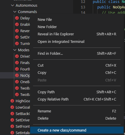

Pro Tip: if you are using VS Code, you can right click on a folder and hit “Create new class/command”:
The command would look something like this:
