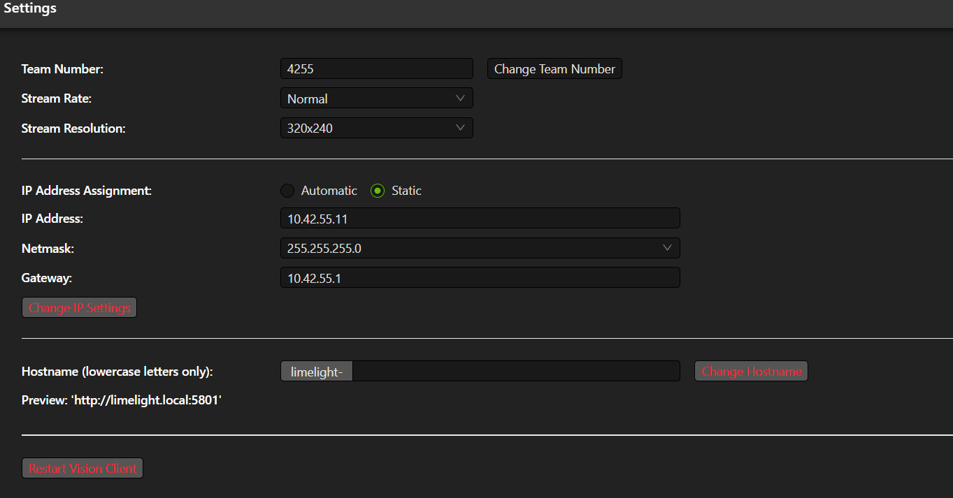

We were able to connect to the limelight through Ethernet after disabling Wi-Fi. The Limelight Finder tool was able to detect the Limelight and we changed the settings:
After that, we power cycled the robot and attempted to access 10.42.55.11:5801 after the Limelight had booted up, but we couldn’t access it. The Limelight orange status light changed to solid from blinking, so we know that it got a static address. We tried turning off the Limelight, connecting it back to the network switch, and connecting the computer to the radio through Wi-Fi. We still couldn’t access the IP address.

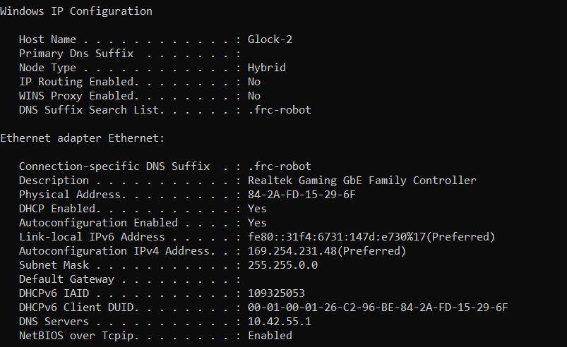

We tried testing again and got some of the ipconfig info. The issues persisted.
Connected to radio:
We also tried using the other Limelight we have, which was working when it was connected to another robot. We’d already flashed it with the latest firmware and gone through the setup process a couple of weeks back, so it has a static IP, but we can’t connect to it either. We reset it to dynamic and were able to connect to it through an Ethernet connection, like the other one, but that was it.
This is the ipconfig info from Ethernet connection with second LL:
I doubt these screenshots provided enough info, but I can get some more tomorrow once we have a proper team meeting.
