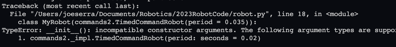

I am doing a lot in our robot code this year and have basically given up on getting it under the 20ms loop so for PID’s sake I want to have a solid, exact robot loop time however when I try to specify this in the robot class initiation I get the following error, though I am not sure how else to format the parameter. I am sure I am missing something fundamental here, I just can’t see it.
class MyRobot(commands2.TimedCommandRobot(period = 0.035)):
    def robotInit(self):
You need to override the __init__ method and call super().__init__() with your desired arguments.
def __init__(self, period = 0.035) -> None:
        super().__init__(period)
Worked flawlessly thank you. I’ve been using polymorphism extensively in the code base and have been overriding inits in the command base but I never thought to add in the init() function into the code as robotInit() is already present. Thanks again.
