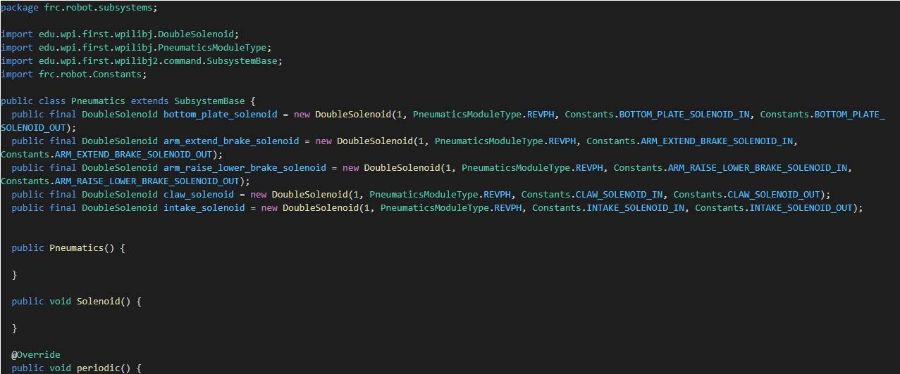

This is what our code looks like:
Analog or digital switch? We’re using the analog switch for the first time this year, and turns out that was our problem. I wasn’t there when they fixed it (working on a different problem), but you have to specify that it’s analog and the channel it’s plugged into, as there are two. Once they got that going, it started up with code just fine!

Okay, we had everything correct except we were missing enableCompressorAnalog, which we now have, and the compressor is working.
