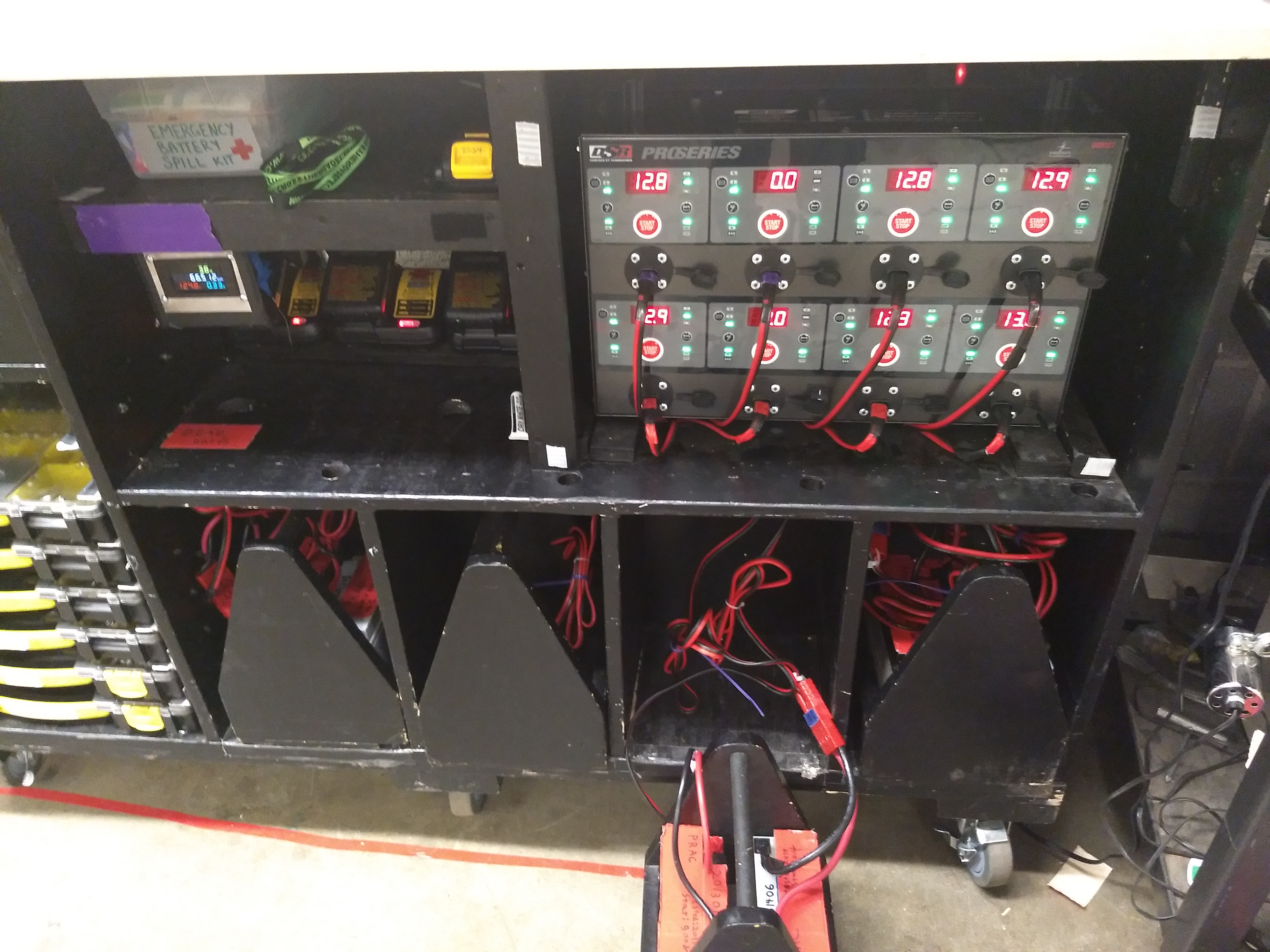

For many years we’ve coped with a dozen partially working harbor freight chargers. After buying a set of new competition batteries this year and finding out they were AGM which didn’t really work with the chargers we had, we looked at replacing them last fall.
Instead of a set of individual chargers, we splurged and ended up with an excellent deal on a Schumacher DSR127 which is a pro level 8-bank recharger/reconditioner.
One of the freshman reworked the old battery cart to fit this and the whole things looks awesome. Even better, it worked great all year.
Downsides:
Not much, but a our testing soon showed that we would draw upwards of 1500 Watts for a minute or so if you quickly plugged in 8 dead batteries. We didn’t wish to blow the circuits at competition so we came up a procedure to plug them in one at a time and wait for the power to come down after its initial diagnosing phase. It usually will be around 150W per battery after the initial diagnosis tapering down as it gets close to filled.
That is what the colorful thing is in the corner – a volt/amp/watt meter that cost about $12. Not only does it tell us what we are using, but its perfect for showing inquisitive LRIs how much current we are drawing.
Also list price is really expensive. I’ll say that we paid a whole lot less.

This looks pretty cool, how do you make sure you meet the current requirements in R42, I was looking at the product page and I don’t see a way to limit max current to 6 amps. Is there a switch or setting somewhere?

Sorry Mark, I meant to reply to @KelleyCook but clicked the wrong button. I apologize I know how the NOCO chargers work, I was referring to the Schumacher DSR127

Before buying, we were concerned about this too (even though other teams we respect use similar systems). Then we saw this post by the ever helpful @Al_SkierkiewiczBattery Cart
Basically, as he mentioned with the McMaster-Carr 8-bank model, this Schumacher smart charger quickly figures out the battery type and charges them correctly.
The sales blurb says each back can adjust between 5-12A, but If you look at the DSR127 specs it states each bank is rated for a continuous output of 12V/7A which is more reasonable expectation.
Battery Type: Standard, AGM, Gel, Deep-Cycle, Lithium Ion
Input Voltage: 120V AC
Input Current: 12A
Output Voltage: 6/12V
Output Current: 12V, 7A cont; 4/12A int
Dimensions: 23.75 × 17 × 15.25 in
Weight: 40.11 lb
Safety Certifications: UL ULC
Warranty Period: 1 year
After getting it, we implemented “Trust but Verify” by watching the draw meter and except for a very short testing phase, the smart charger stays well under 6 amps for both the Lead Acid (now our practice batteries) and the AGMs we purchased for last year. For topping off batteries it usually significantly less, like <2A.
Its also another reason for the AC Amp/Watt meter on the side. One of the electrical mentors felt we could demonstrate this at a competition if it was inquired, though no one has ever asked us too.
