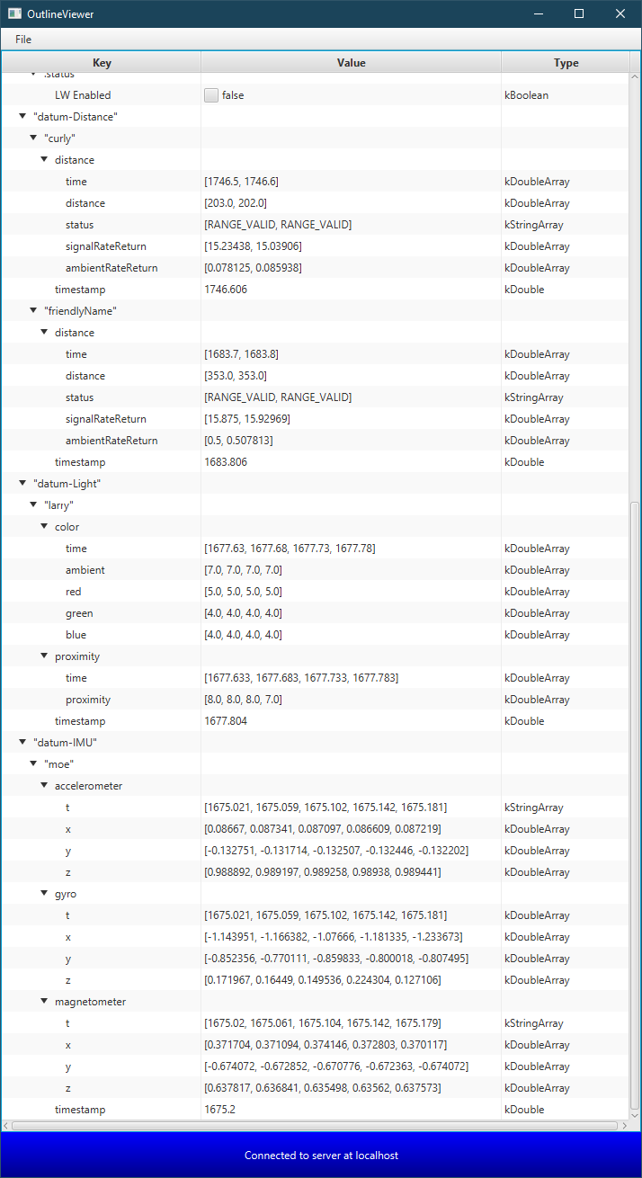

We’ve got another sample project available now on GitHub! This project shows how you can autodetect any of our datum smart sensors and have their data automatically published to a network table.
Have multiple sensors of the same type? No problem. Set the friendlyName parameter on each sensor to something unique and the data is automatically published under that name. Our datum-Light color sensor, datum-Distance time-of-flight laser ranging sensor, and datum-IMU 9 axis inertial monitoring unit are available now through GroupGets!
