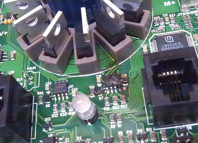

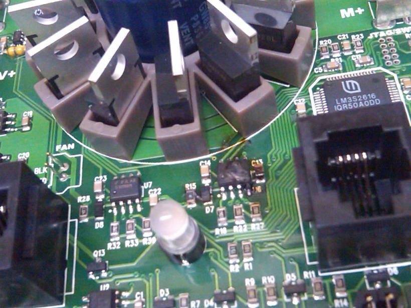

It has started again. We have already toasted two Jags from last year. We purchased a number for last year’s bot and removed them all from the robot after toasting 4. We just built a prototype drive base and in two days have smoked 2 of the “replacements” we got last year. Same symptom, it only loses one direction after issuing the magic smoke. I really wanted to move to CAN, but I CAN’T if I CAN’T rely on the Jags. Has anyone smoked a Black Jag yet???

The direction failures are attributable to one of the power FET gate drivers shorting. I don’t remember if the cause of the failures was ever found or reported.

Looks like ours is a U6/U7 failure.
Team 1279 worked on the Black Jag Beta program and we did manage to blow up two with static discharge, one by accident, and one on purpose (under TIs direction). Last years robots were very static prone, and the encoder and potentiometer inputs are fairly exposed. I would recommend covering the inputs with empty connectors when not using them to prevent that type of failure.
