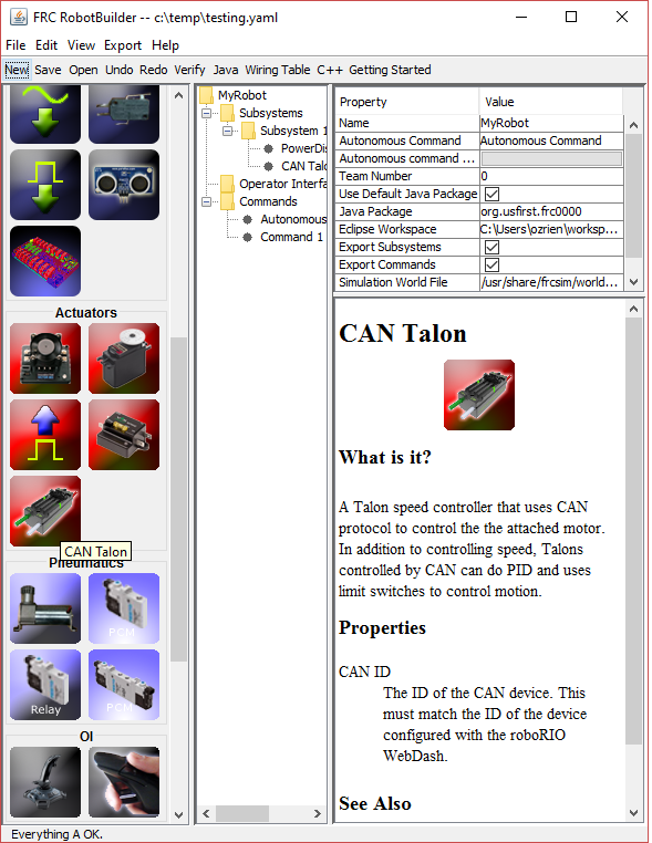

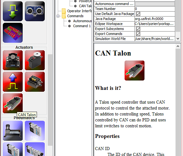

The Talon SRX should be in RobotBuilder. Can you confirm this?
Picture attached.
Omar, Not, RobotBuilder does not have Talon…
We coded everything without Robotbuilder as we could not find a great instruction to update RobotBuilder… We are pretty new and really not comfortable with Java / Eclipse / GitHub and everythign else yet…:ahh: :ahh: :ahh:
It just occurred to me you never actually described any failure symptoms other than [1] missing-talon-in-robotbuilder.
[2] So I’m guessing your problem is that the code doesn’t build?
If [1] and [2], then you likely never installed the CTRE Toolsuite which installs the API for CANTalon, and the RobotBuilder additions for CANTalon. Is that possible?
