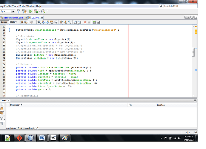

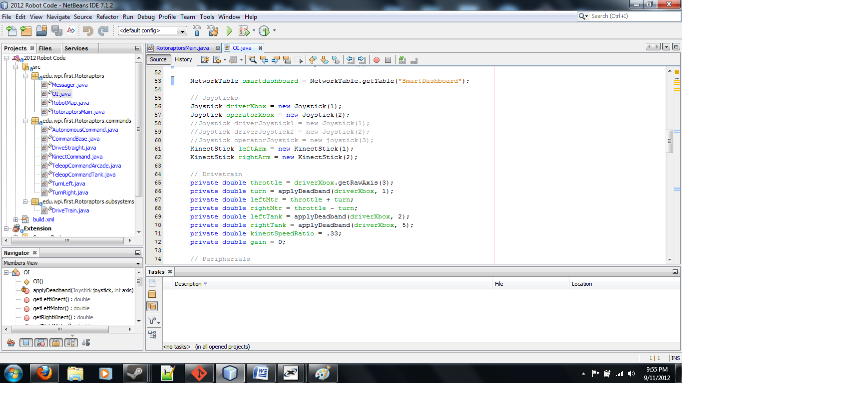

I attached a screenshot of what some of our code looks like at the moment. Even though it looks like a lot, most of the commands only require a few lines of code, and they can do a heck of a lot. Our code, for instance, is able to switch between tank drive, arcade drive, kinect drive, etc with the press of a button on the dashboard, and all of that is achievable with less than 2 dozen lines of additional user-generated code more than what we would have needed anyway.
