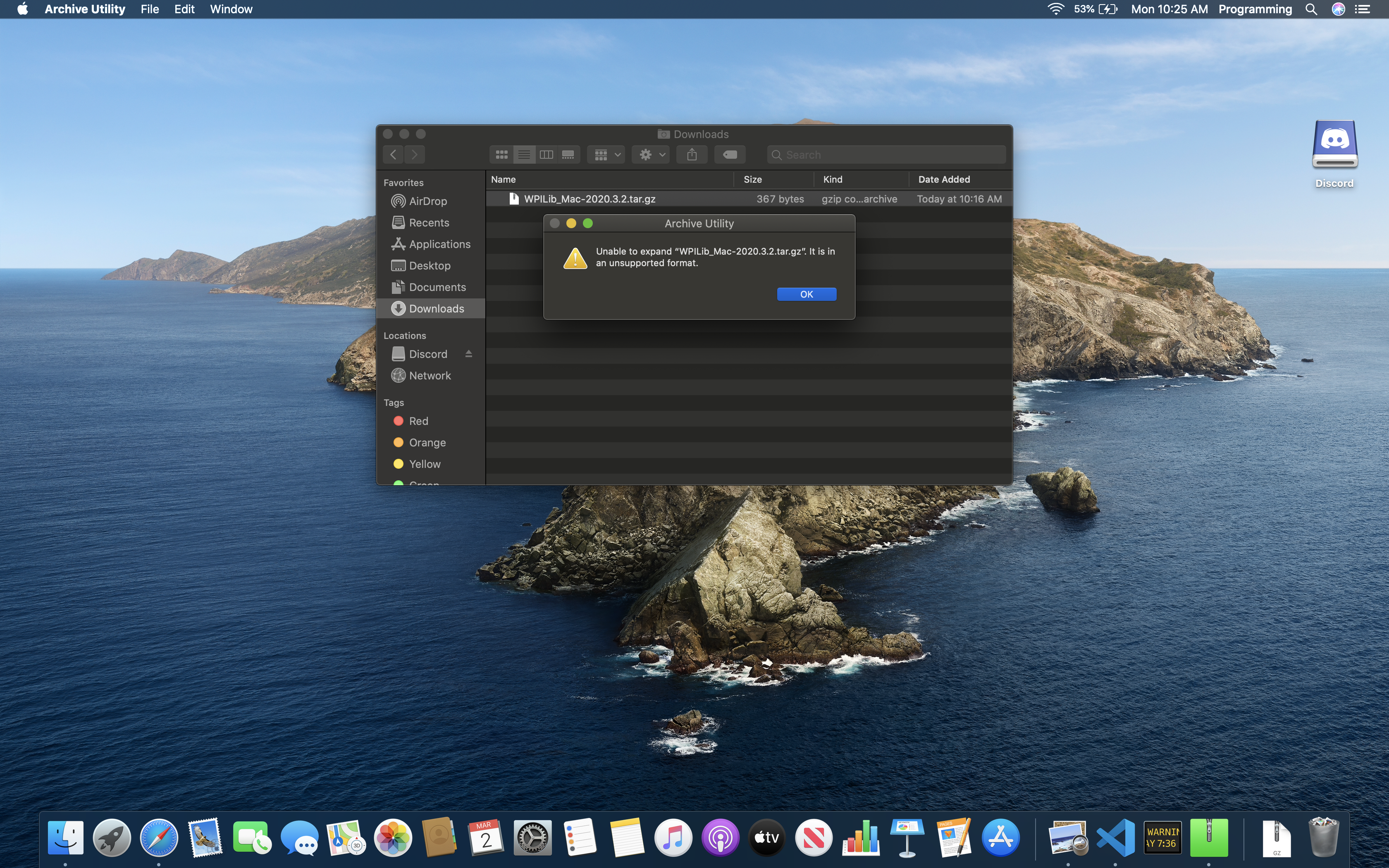

So I tried to download the WPILib for Mac from Github but my MacBook won’t let me expand the file. Says it’s an unsupported format. Any advice?
It looks like you didn’t get the whole file… it says it’s 367 bytes, it should be over 1 GB.
oh yep, it didn’t download all the way.
