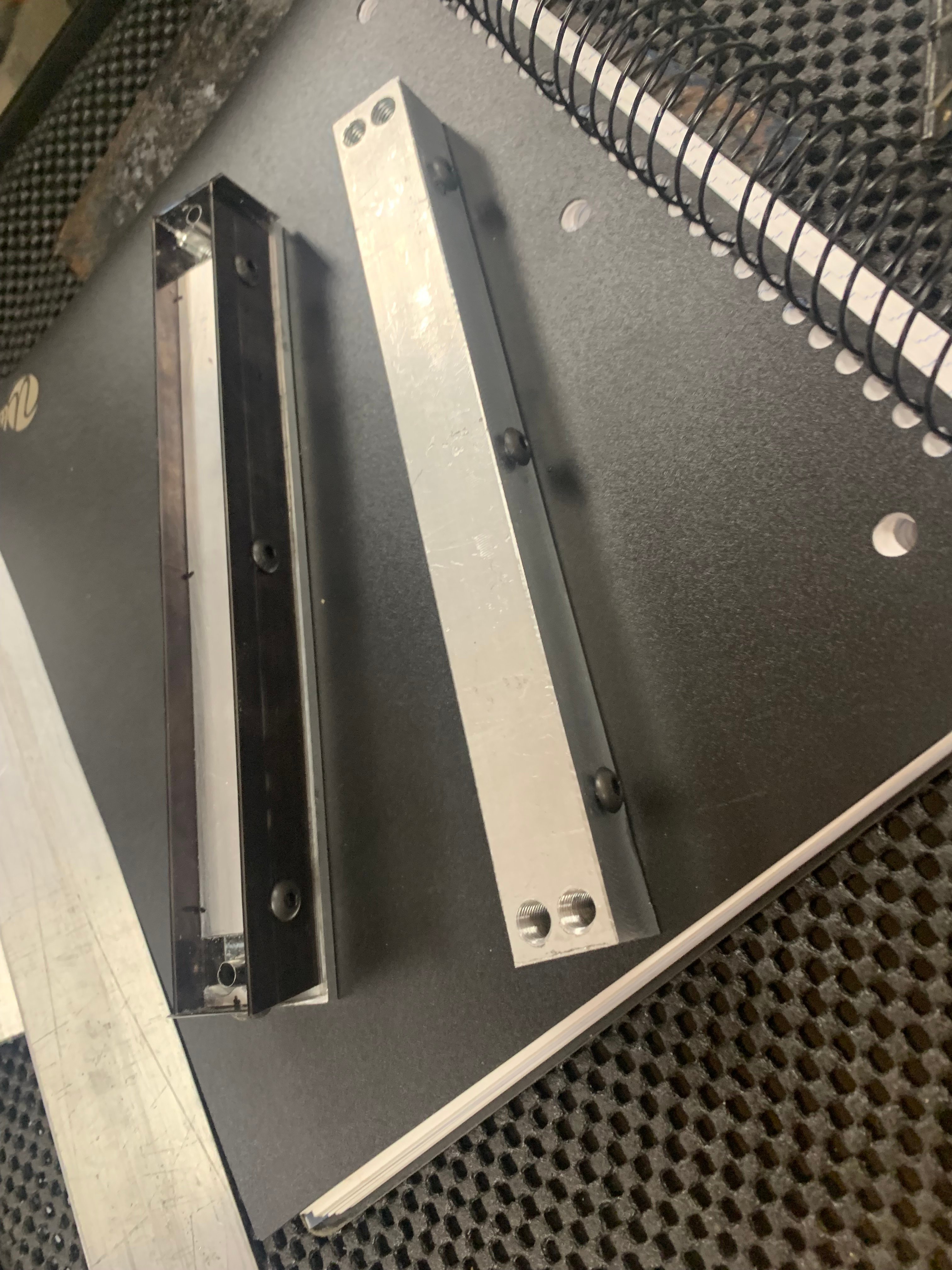

I just finished testing Rev 1 of a new tread cutting die, and results are very promising. I’ll post more when I’m done with Revisions.
Any update?
I have been busy at meetings, so a full post will have to wait, but…
I’m working on a punch die that makes an entire tread in one action. The die is an aluminum block with 5 mm hole punch tips from sailrite, and rule die blades, I’ll release my CAD and a full write up once I have a chance to do final validation and take more pictures.
