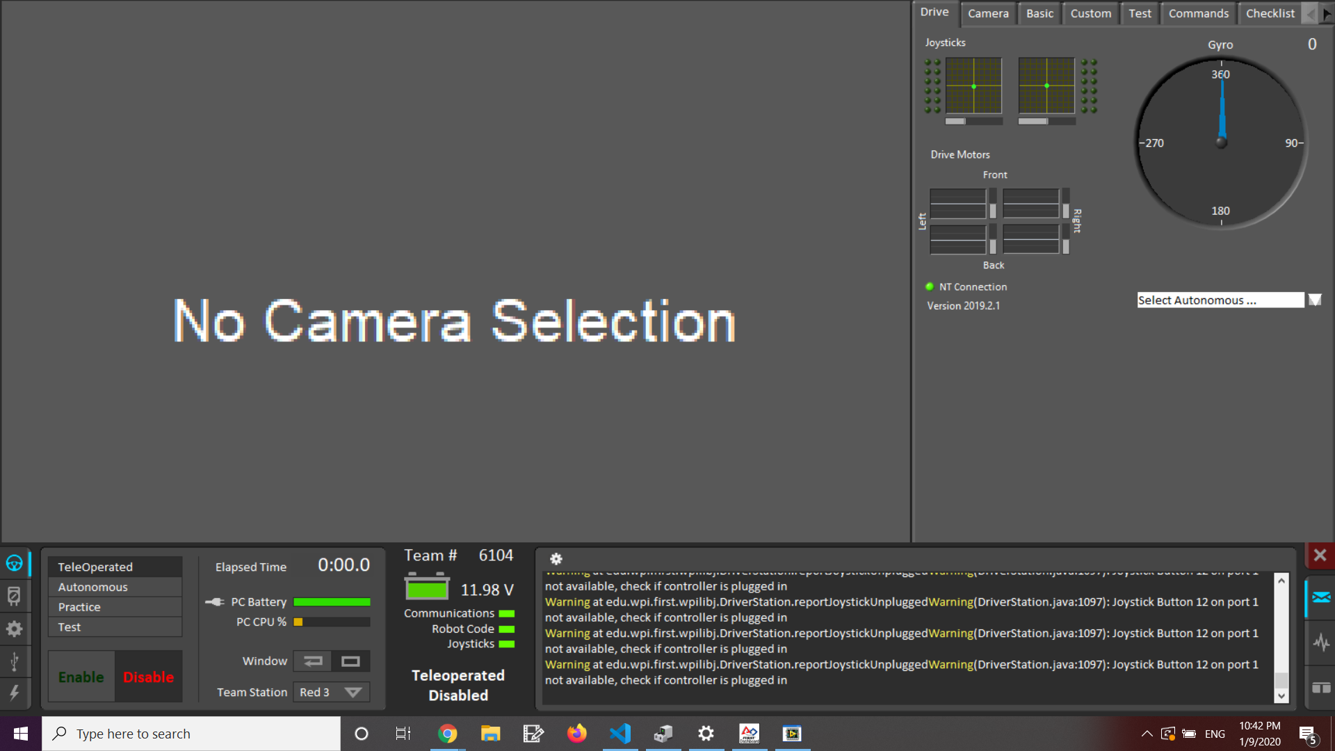

Hi our team uses the “extreme 3d pro” from logitech and although he is connected it gives me this warning :
Joystick Button 12 on port 1 not available, check if controller is plugged in
what can i do?

are you sure that your joystick has 12 buttons? and is the controller in the correct slot of driver station?
yes
interesting…
have you restarted driver station?
yes and i also restarted the computer

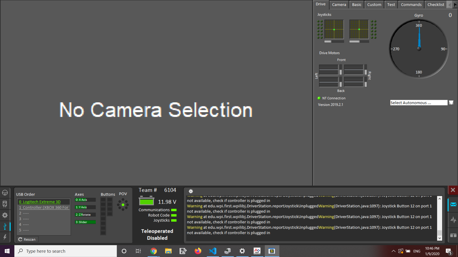

could i see a screen shot of the controller view in driver station?
could you click on the usb icon and send one?
sorry if that wasnt clear
change the port of your joystick to 0. Its really confusing but buttons are indexed from 1, while joysticks are indexed from 0.
thanks! it worked
