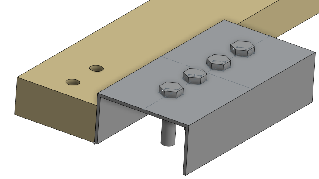

At some point I tried to come up with a quick setup system made with these u-channels (McMaster):
Then some triangle plate with similar bolts for the corners.

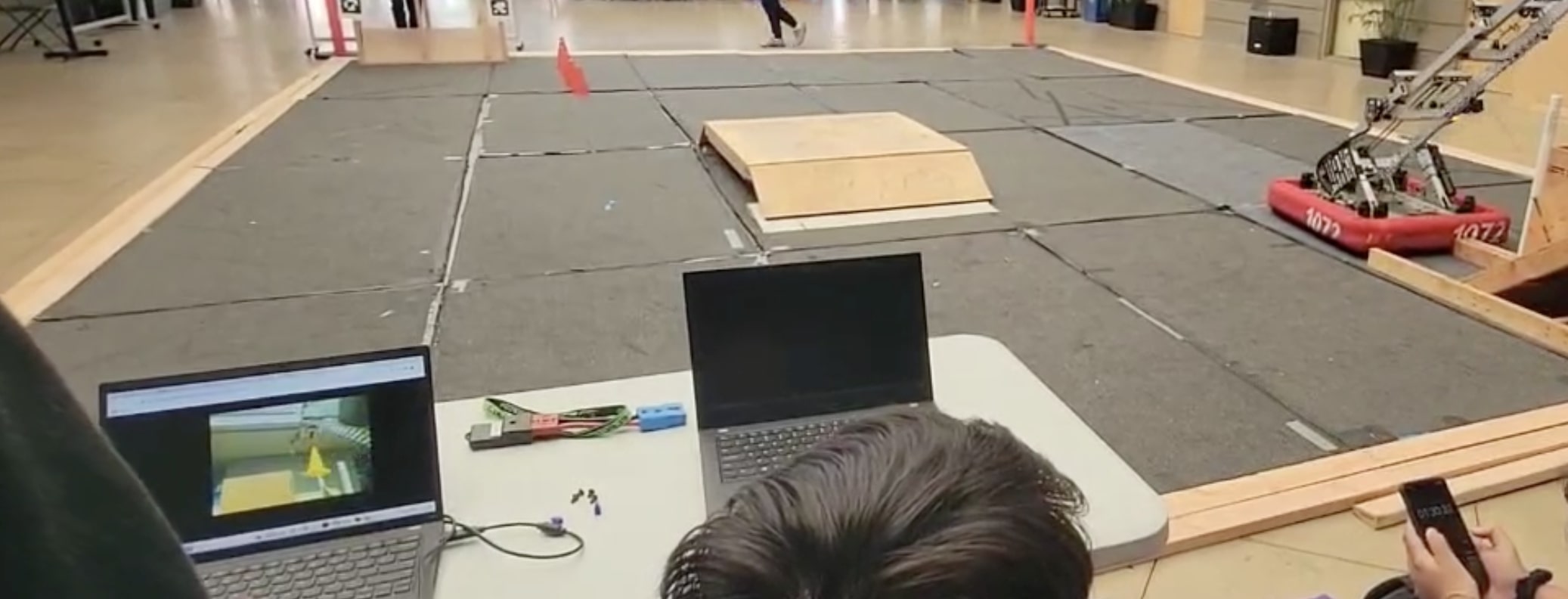

1072 set up 4x8 “carpet tiles”. The carpet is wrapped around the edge of a 4x8 plywood sheet and stapled on the bottom using carpet tack strip and nails. Works amazing and makes the carpet last longer.
If I had to make them now (other people worked on them last time) I would potentially skip the nail strip and just wrap over the edge and staple. Also maybe do thinner plywood, like 3/8".

I’m having a difficult time picturing what you mean with the u-channels. Where would the carpet be in the picture?

Sorry, combined two ideas and didn’t show the end result. Here is a link to the Onshape to see things “connected”:
Hook tape would go on the underside of the 2x4s, then the u-channel would go INTO the holes in the wood.
I like it! Thanks for the clarification. I will see if we can get a team to build it and I will post our results!
Is there any pictures of the carpet tiles? How to you keep the tiles together?
Each tile is 4’ x 8’ made with a base of plywood, nail strips, and then carpet stretched over. The tiles are about 30 pounds each, I’d estimate, but they’re large and so they take two people to carry. We can usually lay about 26 tiles in 6-8 minutes with a team of 4 working on it. They’re really nice for the various configurations you can have the field in but one major downside was that they shift a lot as the robot drives over them. The field is 24’ x 32’ max size.
To address this, we built a “field frame”, a series of 2x4s like a photo frame stretching around the field and holding everything together. The frame supports two configurations, 24’ x 32’ and 24’ x 16’. The frame takes about 10 people and around 15 minutes to assemble, but we usually leave it down for weeks on end, only packing it up when necessary. Additionally, when packing up, we usually only take apart the joints that are absolutely necessary. We’re able to store pieces up to 16 feet long and so we only take apart about half the joints each time.
The tiles are about 1" tall off the ground and theres about a half inch discrepancy between the 2x4s of the frame and the field tiles. For this, we designed an inner frame and an outer frame. The inner frame is a series of beveled 2x4s providing a ramp from the height of the field tiles to the height of a typical 2x4. This makes the transition from the field tiles to the outer frame smooth, in case the robot happens to go over the edge. The corners of the inner frame are done similarly, with beveled pieces. The outer frame is built with a series of 2x4s held together with steel mending plates (link below). The corners are cut at a 45 degree angle and bolted together.
When setting up the field, we begin by assembling the outer frame while simultaneously laying out the field tiles. When those steps are complete, we push the tiles together and drop in the beveled pieces to make the inner frame and lock everything in place. The frame works well for the most part, the wood does flex a little and some gaps do develop between the tiles over time, but they’re usually small and just take a small shove to push them back together. The frame is significantly better than having the tiles shifting multiple feet apart every time the robot touched them. I’ve uploaded the best picture I have access to right now, but if you’re interested, I can get more detailed pictures of the tiles themselves and also the frame when we next put it out.

I have a few follow up questions. Do the tiles ever develop wrinkles in the carpet that require the carpet to be re-stretched over the plywood? We are planning on laying these out semi-permanent so we were thinking of using 4 inch wide gaffers tape along all the tile seams to help hold the tiles together and provide a smoother transition between the tiles. Have you ever tested taping the tiles together and if so did it help?
The nail strips make it such that the carpets never wrinkle. We have gaff tape running around every tile to make the edges smoother. We haven’t tried taping the tiles together but we did try Velcro on the edges once upon a time. Personally, I think that laying the tiles out with Velcro on them is a huge pain because if they touch, then they stick, and its a massive effort to pull them apart, align them perfectly, and shove them together while keeping them aligned. The Velcro has pulled apart in some of the more extreme cases, but it usually holds together. I’m not sure if gaff tape will be strong enough to hold the tiles, there is a pretty good amount of force on them from the robot.
