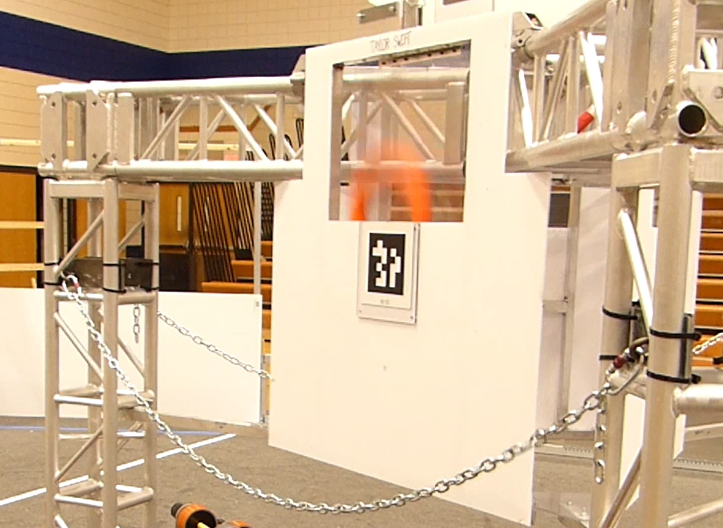

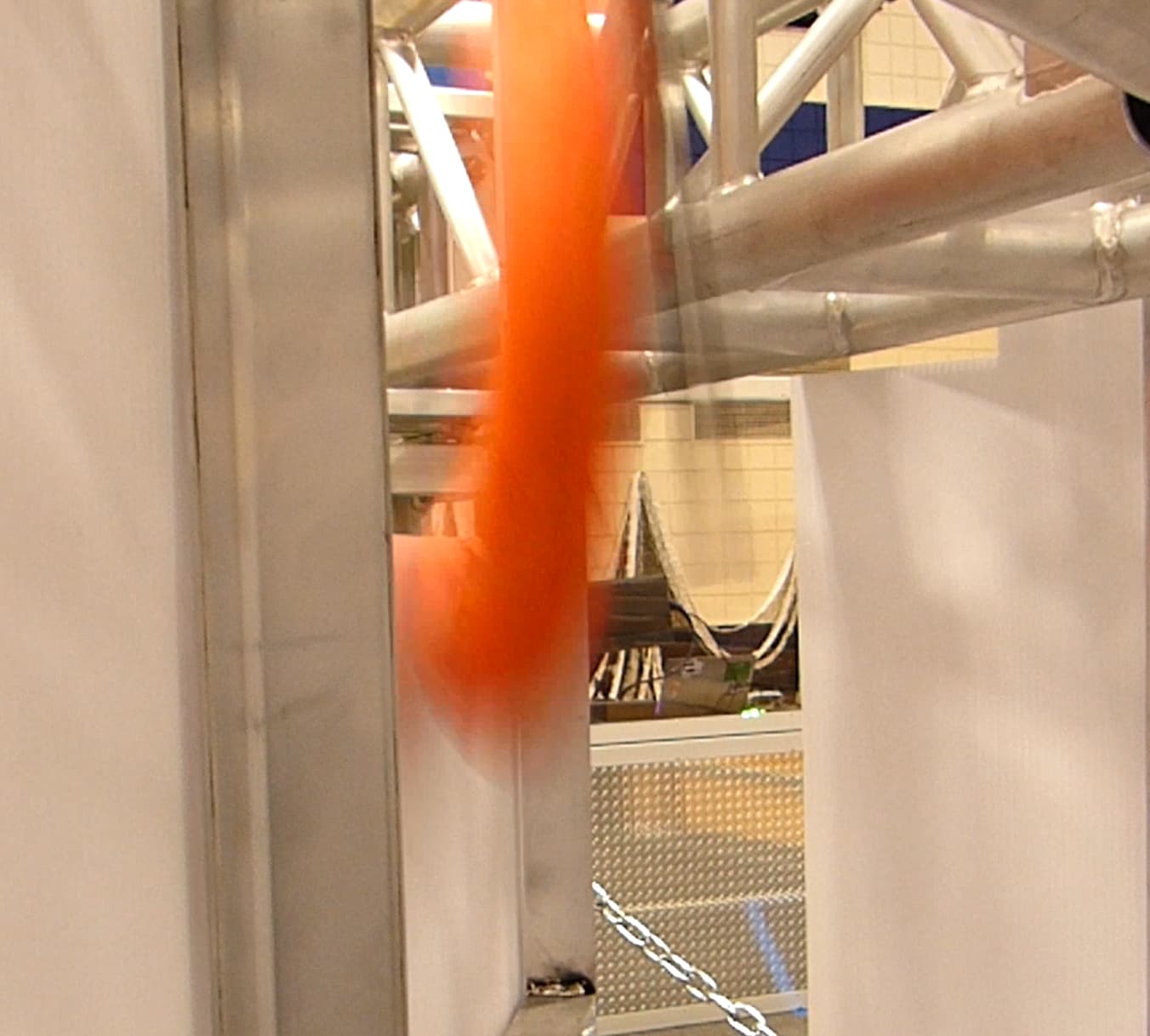

What I learned is I need to build the trap chutes. The shot looks like it works from the front.
But from the back, the bottom of the trap door is opening much farther than the actual field allows. Maybe twice as far. As much effort as we put into the stage, it’s still not good enough.
We’ll try again next weekend.
