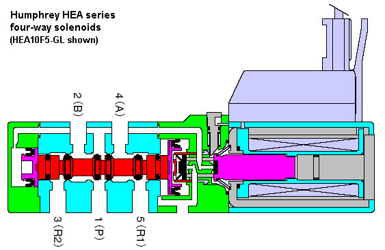

Hello everyone! I’m trying to figure out what the small magnetic pins would do inside of a Koganei HEA series solenoid. It seems that these demagnetize over time and cause older solenoids to exhibit issues when undergoing high-frequency cycling. If I’m understanding the operation correctly, these pins simply act to transfer force from the armature up to the piston that activates the pilot valve - so why would they need to be magnetized?

And a (unfortunately unlabeled) diagram of the solenoid:

Update… Somehow I used the right keywords and found the patent. Assistance in understanding would be appreciated as well. The part I’m describing appears to be part number 46.

I have purchased some of these new from the manufacturer within the last year, and the interlock pins are certainly magnetized new, and lose it over time. Swapping the interlock pins seems to give new life to an old solenoid (dwell time for a cycle reduced significantly). Swapping the spools didn’t seem to make a difference.
After reading through the patent last night, I came to a similar conclusion that the magnetization is somewhat irrelevant. However, on a solenoid that has been cycled hundreds of thousands of times, it’s likely that the conical springs are worn out. But on the downswing of the armature of the solenoid, if those interlock pins are still strongly magnetized, they assist in closing the flapper valve by an attraction to the spring behind the flapper. As the interlock pins lose magnetization, they no longer assist in this action, and the flapper valve relies only on a tired, old conical spring to close it.
That’s the only way that I could reason that swapping the interlock pins between a new solenoid and an old solenoid seems to give it some new life - but my guess is replacing the springs would have a far greater impact.
