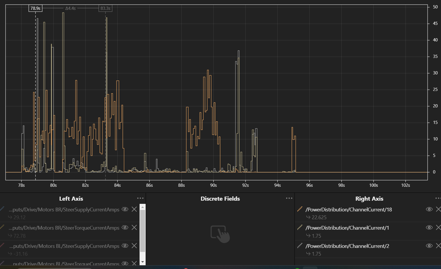

Some data from our most recently failed motor showing current drawn from our pdh for our swerve drive.
The yellow and tan graphs represent other steering motors on our chassis that are operating normally. The orange represents the motor in question.
It seems there is no correlation betcorrelationr in question and the other 2 normal working steering motors.
More graphs that can quantify other above/uncorrelated mentioned issues will be posted tomorrow.
