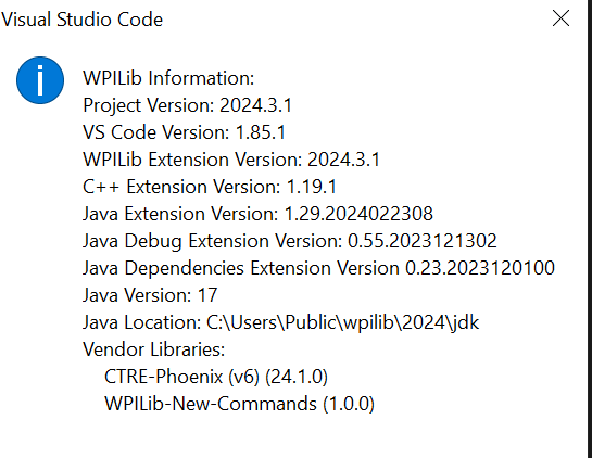

Versions:
WPILib project versions:
Kraken x60 firmware version: 2024.2
