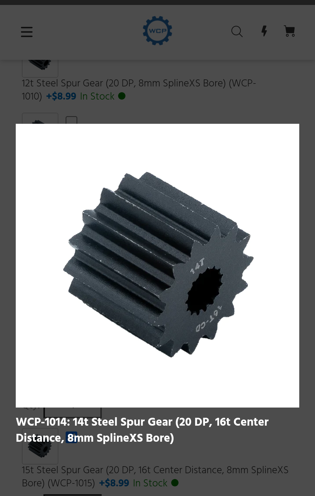

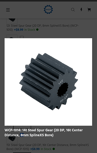

This one specifically
I hope that item from WCP will work. The SDS page says the Kraken kit includes “Gear, 20DP, 14T SplineXS Bore” so that is what i ordered from WCP. Our Krakens arrived today, the gears should be here tomorrow, so I hope they work!

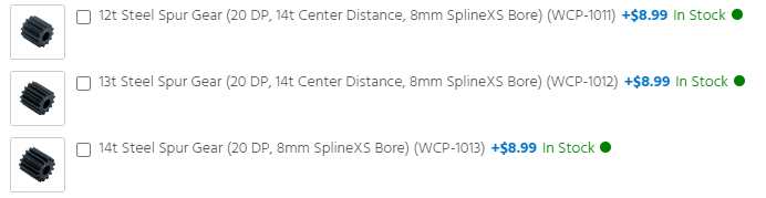

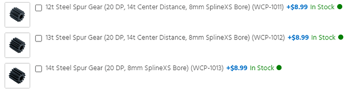

Looks like it might be too big, it’s 16 cd while R.C. says we need 14 cd. Do we need item 1013 rather than 1014?
I think you have the wrong gear, for the stock SDS module if it is requiring a 14T gear you will want to use any 3 of these. Pat or someone else can correct me on this one?
If you have ordered the wrong gear, please send me a DM here with your order # and we’ll work to get you gears swapped so you can get up and running.
