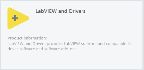

@tylerblockbuster, if you mean you installed LabVIEW 2019 from the standard (non-FRC) installer? If so, that’s not a big deal. FYI:
Correct: image
Not Correct: image
The difference between the two is largely the environment, which is what NI calls the default window that comes up when you first open LabVIEW. The FRC environment gives you the option to create an robot or dashboard project from a template, and easier access to the help.
The real important piece to make sure you have correctly installed is the FRC Game Tools, which gives you both the utilities like driver station and imaging tool, but also libraries and drivers to program your robot. That absolutely has to be on the current year version.
