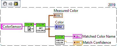

Read the sensor in a loop in Periodic Tasks.vi and write the color to a variable you created in “Robot Global Data.vi”.
Now in teleop you can simply see the color the sensor sees by reading the RGD variable and control your motor appropriately. There are other ways to go about it but this is the easiest to get going.
You can do the color check in either Teleop or Periodic tasks.

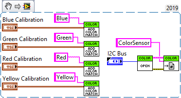

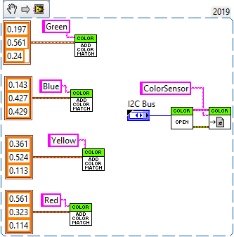

Did you end up with something like this in Begin?
InBegin
or
InBegin2

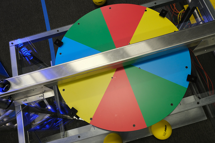

Most teams will not be looking at the same spot on the color wheel as the field sensor, so you will have to translate the GameData color into the corresponding color where the robot is.
E.g., if the GameData color is Yellow, your robot may be looking for Green (2 colors away from the field sensor).
In this photo, the field sensor is in the aluminum bar running across the top of the color wheel,
but the robot may be looking at the overhanging edge at the top or bottom of the photo.
So, when yellow is under the field sensor, green will be at the overhanging edge.
ColorWheelTop

For the begin vi I tried to do both of the examples you gave, but I wasn’t sure if a I needed specific RGB values, but I’ll use the ones in your example to start out.
The second pic you have of the begin vi, what are those brown wires/icons called, as in what do I select when I right click the color match box? A constant didn’t give me that.
Thank you again for your time!
The RGB constants shown are just those from the Rev example project and seem to work well enough.

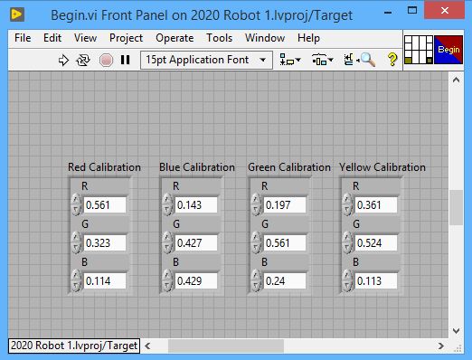

The second Begin example snippet is identical to the first one, except instead of Create->Constant choose Create->Control.
The difference is that the control method puts the RGB values on the front panel where they are easier to tune/adjust while running your LabVIEW project in Debug (white arrow) mode at home.
If you don’t plan to play with the values, then making them constants is sufficient.
If you use controls then:
  • You will have to enter the Rev example constants into the front panel to start with.
  • Once values are entered on the front panel use the Edit menu and choose “Make current values default” (Otherwise they will revert to zeros when you close the project).
BeginFrontPanelControls
During competition you’ll be using fixed constant values, but they can remain as controls with the values you want made set as defaults.

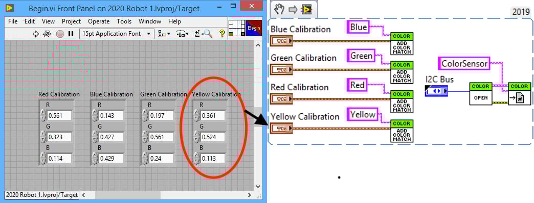

I would like to know what the brown boxes are on the Teleop & the Begin because my friend and I are working on it.
The brown boxes are clusters. So it represents several values smushed together in one wire.
In my picture you see what the brown box in the code view looks like on the front panel.
To add on here.
You get those clusters by
  • right-click on the left brown node on the Add Color Match vi
  • Choose Create->Control from the pop-up menu
