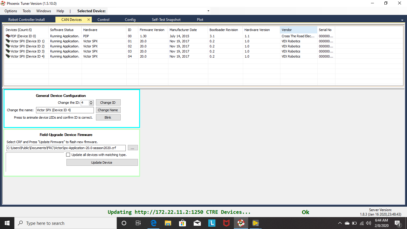

All we get is orange blinking lights on the MCs.
What is wrong with our code?
We are using 4 motors (2 left/2 right) each with a Victor SPX from CTR and a Logitech Extreme 3D Pro joystick.
Here is a look at our Tuner devices. They will blink when selected. Do we need to do anything else to them?
No luck so far, just blinking orange LEDs on the MCs.
Do you need to do anything else to them to configure them?

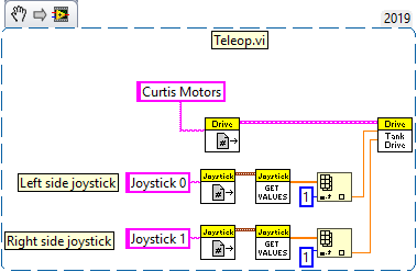

This code is very wrong. You have code to open and define motor controllers in the same vi as the code you are trying to use to drive the motor controllers.
Also this code is in some custom vi called Chris.vi
Inside of what vi is this code running?
Your code that opens the motors belongs in begin.vi and the code that drives the motors belongs in teleop.vi

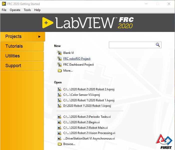

To start from the default Arcade Drive program:
  1. Open LabVIEW and you should see this window if everything has been properly installed (Note: all that stuff under OPEN is just a list of the most recent files that I had open on my PC here at home):

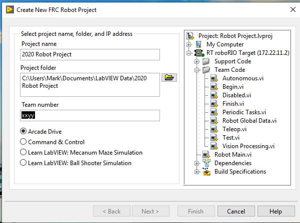

  2. Choose FRC roboRIO Project under NEW and you will get this:
  3. Enter your team number in the highlighted field and click FINISH to get your default Arcade Project. Your Team number will identify your robot to the competition field and to your Driver Station app running on your PC. There will be a lot of robots and the team number is how we tell them apart.
    3
Expand the Target and Team Code directories and you will see the vi’s that you should be placing your new code in.
This project is a complete user code as is and can be downloaded to run of your roboRIO.

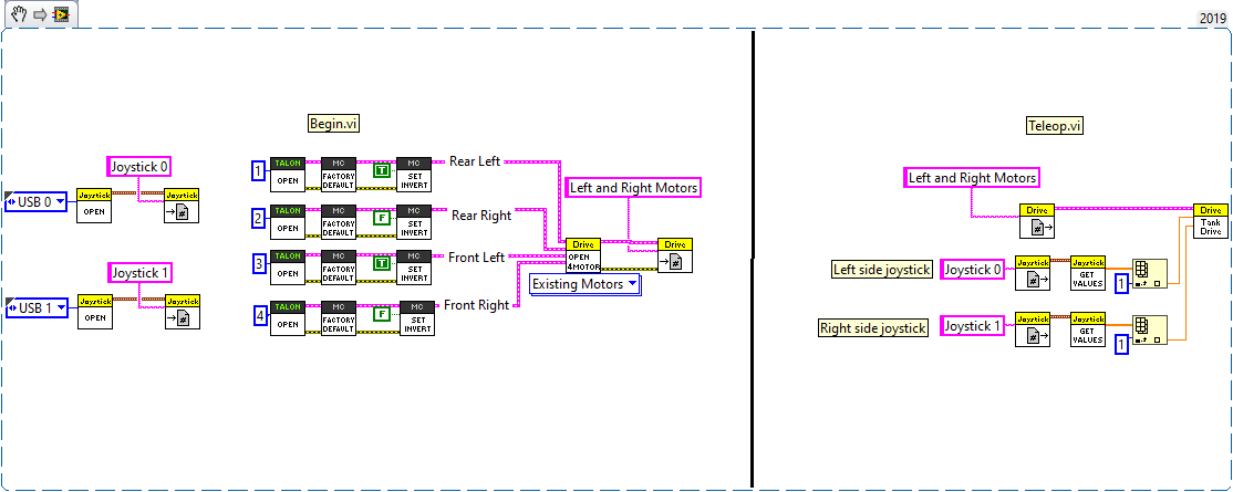

Now you can go back and edit Begin to add in your specific Talon code.
So, to help with this I’m going to modify my original suggestion slightly to make it easier for a beginner.
None of the code that follows conflicts with the default code that is already there, so just add these, don’t delete anything else.
Note: These pictures that follow are actually LabVIEW code.
Same them to your desktop, then drag the file onto a block diagram to add the code to your project. You can also enter this all by hand if you want practice.
  1. Open the Begin.vi project and drag/drop this image onto the block diagram:
    AddToBegin
  2. Open the Teleop.vi and drag/drop this image onto the block diagram:
    AddToTeleop
Do the Build and Run as startup process with this and I’m hopeful your Talons will stop blinking.

I feel we are getting closer. Another silly question, however, on the drive code, do we need to switch from PWM 0 to something else as we are using CAN?
Yes, normally you’d just comment out that section of code, because what I provided above replaces it.
However, the code and steps I provided above just sidestep that issue.
It will work, as is without any additional changes.
It will have the default logic to drive motors off PWM 0 & 1, and the extra code to also drive motors over CAN.
They can both be there. They won’t interfere with one another, and nothing will happen if you don’t plug anything into the PWM outputs. If you do plug something in then those will work, too.
