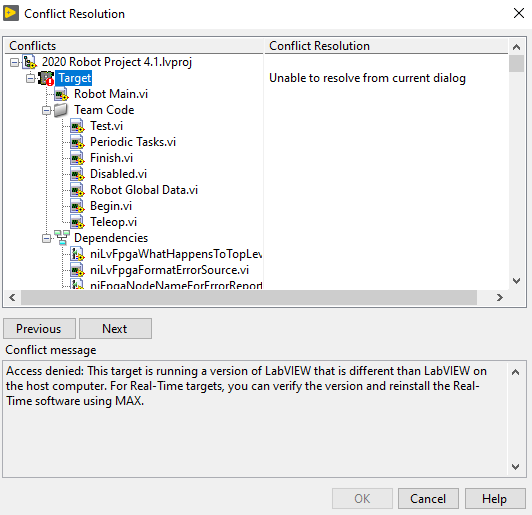

We are finished with our build (I know we are slow) and trying to get our code in Labview ran. WE keep getting this message and we do not know how to fix it.

Usually that is the message you get after updating Roborio to 2022_v4 but your are still running Labview FRC 2020 version.
Why is your project called 2020 Robot Project?

I was trying to run old code that we knew worked from last year. To see if it was just our new code not working.
Check that you are developing in the current 2022 environment and not 2020. The Real Time version of LabVIEW on the roboRIO is not matching up with the dev environment. So when you do a build it isn’t going to allow it to run on the target.

I cannot comment on legality of using 2020 but from a LabVIEW developer standpoint I have seen this issue when trying to deploy code developed in a version of LabVIEW different than the the version running on the Real Time Target.
I would suggest updating your LabVIEW version to 2022 using the previously provided link in this thread and then save your code up to the current version and rebuild.

You have be able to install Labview for FRC 2022 on your development PC.
The code you developed is not dependent on the version it is developed on. You can open a project developed with 2020 in the 2022 Labview and it will run fine.
I solved the issue. Thank you. I just did not follow the proper procedures in installing 2022 software.
