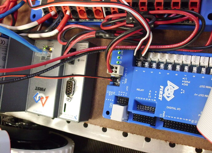

Hello I am the programmer for team 4717. This is our first year first in the competition and we are having trouble getting our code to work properly in our robot, we have isolated the problem to our labVIEW code. We can get one one joystick to connect to the robot at a time even if two joysticks register on the dashboard only one will operate. Any sort of help will be very appreciated.

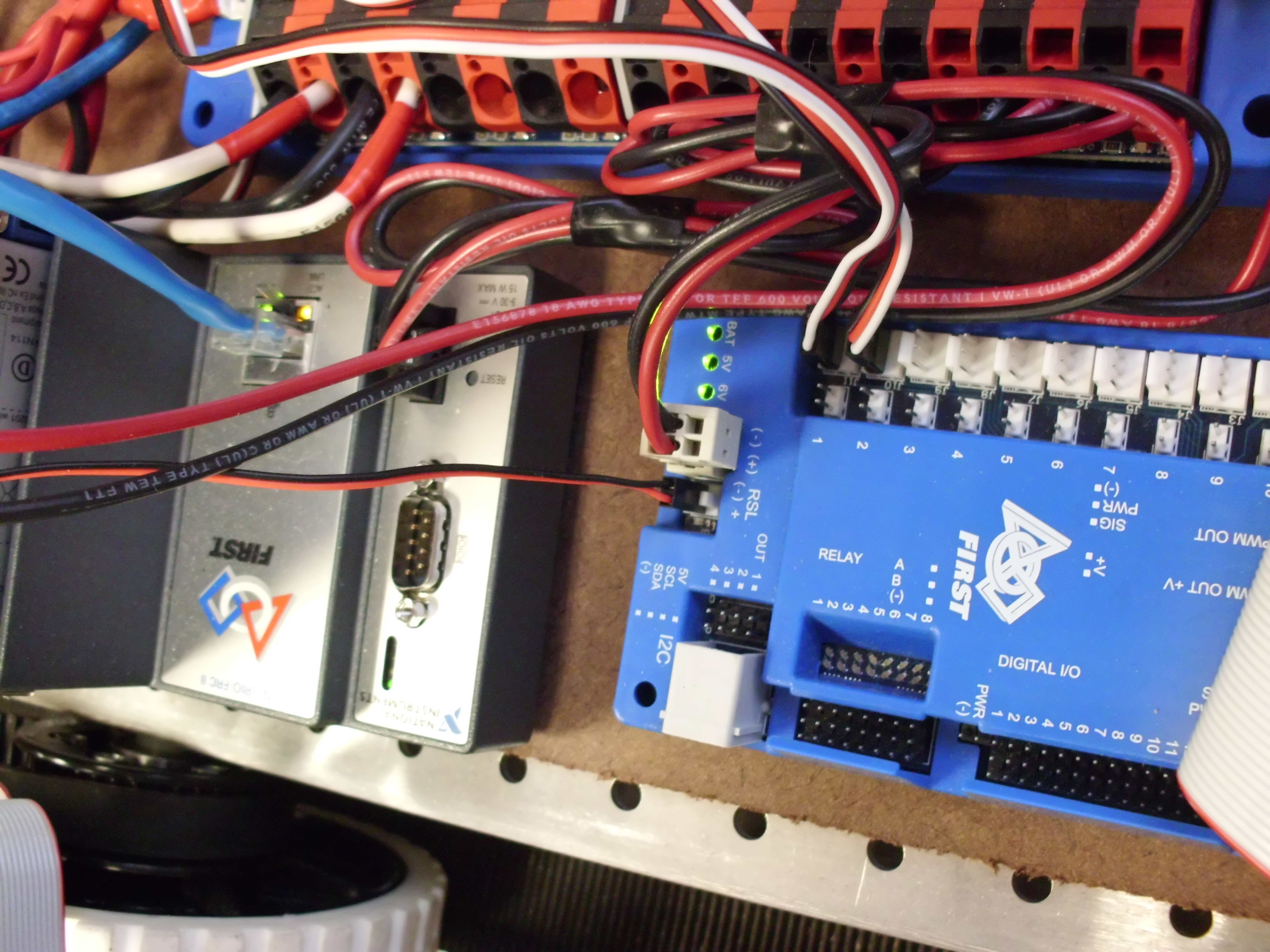

We are plugged into PWM2 which is actually sending working signals to the motor controller. PWM1 and PWM3 …not so much. Tell me what pics you want to see and we will take them.
I’d like to see a photo of the Digital Sidecar with power on, showing the wiring and status lights.

The Sidecar looks clean and the connections proper.
Power is good.
One candidate is a bad or reversed crimp on the 37-pin ribbon cable. Especially since they had to be hand-made, those have a high potential for wiring issues.

I assume that if the PWM connections at the Sidecar are swapped, that the corresponding inoperable Victor then starts operating normally?
And PWM 2 is still the port that works and PWM 1 is the port that doesn’t work?
The 37-pin cable forms a simple loop. We will run it through the multi-meter later this afternoon just to be absolutely sure all is 100% with it.
Yes, if we swap the PWM connectors, the other Victor functions.
However, it’s PWM 1, not 2, that’s working
It runs! Everything works great, it turns out the sidecar had a faulty port 2 so we just switched to another and it works awesomely. Thank you everyone for the suggestions and help. Good luck with your own projects.
