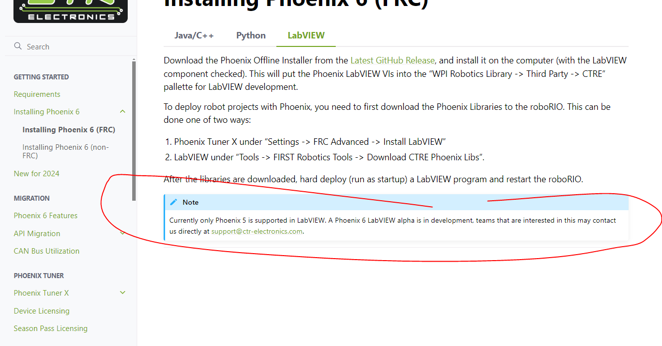

Hey I’m wondering if anyone here is using the Labview Alpha, I tried following the steps on Github but every time I pull the VIs it tells me there are project path errors and doesn’t let me place the VIs. My only deviation from their steps is it says there should be a Phoenix 6 folder In my program files, but when I followed their file directory I could not find it in my files. Any help or suggestions are welcome as the CTRE docs are sending me in circles.
As far as I can tell, Phoenix 6 for LabVIEW has not been released yet by CTRE.
They released an alpha for lab view teams we got on GitHub via a link they emailed us directly. one of the problems I’ve run into is in their directions it says we need to download phoenix 6 for lab view but I can’t find where to do that because their link sends you to the page you’ve just shown
