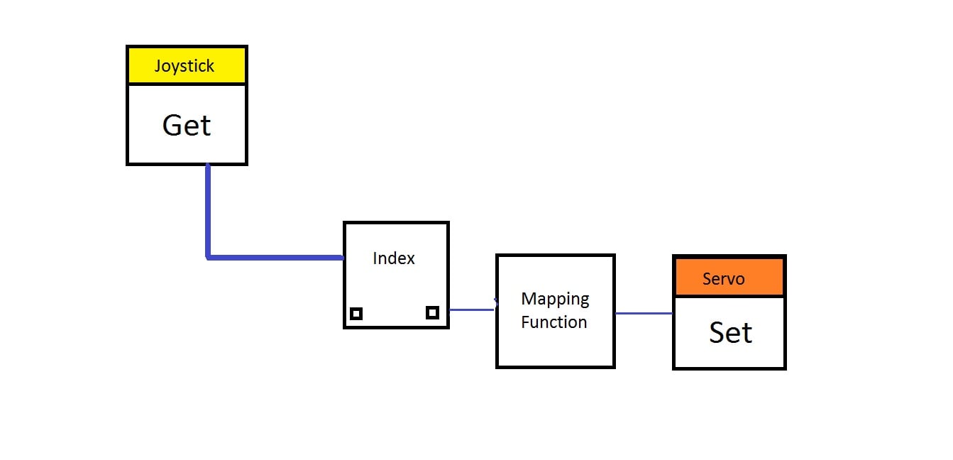

Hello ladies and gentlemen :yikes: , our team wants to control a servo with the hat switch on top of the Logitech Extreme 3D Pro, but we’ve but attempting to program the hat switch for a week, we can use the servo with buttons, but we are stuck at trying to use the POVs for the hatswitch. any help or idea would be helpful.
POVs in LabVIEW have recently been made much simpler. The same way you would get the axes and buttons on a joystick, there should be a third output array on the Joystick Get vi for POVs. The POV you want will be the first (and only) element in the array. If you index the first element of that array, you will end up with a single integer value. IIRC that integer corresponds to the angle that the POV hat is at, with forward being 0* and CW+. Then you can either send that angle value directly to the servo if you have a 360* servo or use some kind of function to map POV inputs to servo angle outputs. Good luck!
Can you show us an example by chance? we still are having trouble, after reading your reply, Thanks!

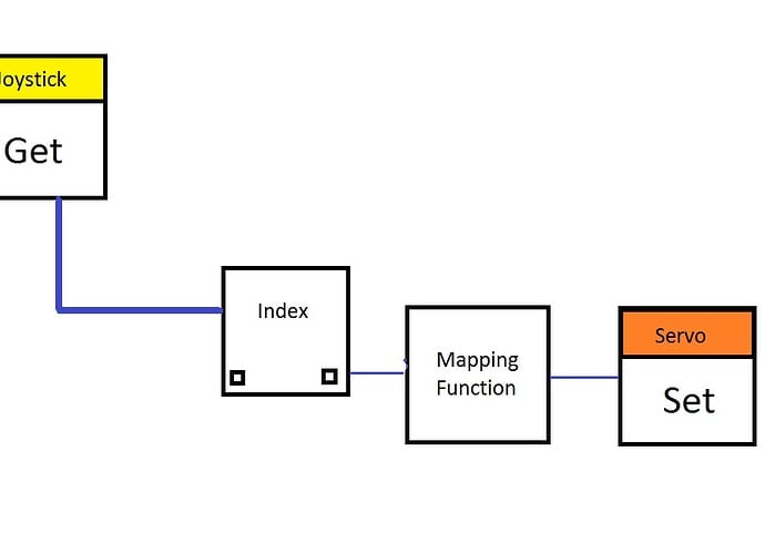

My LabVIEW expired and I’m too lazy to put in the new activation code. Attached is a bad MS Paint drawing of what I think it looks like from memory.
Here, this diagram should be very helpful.
