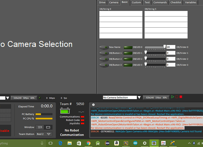

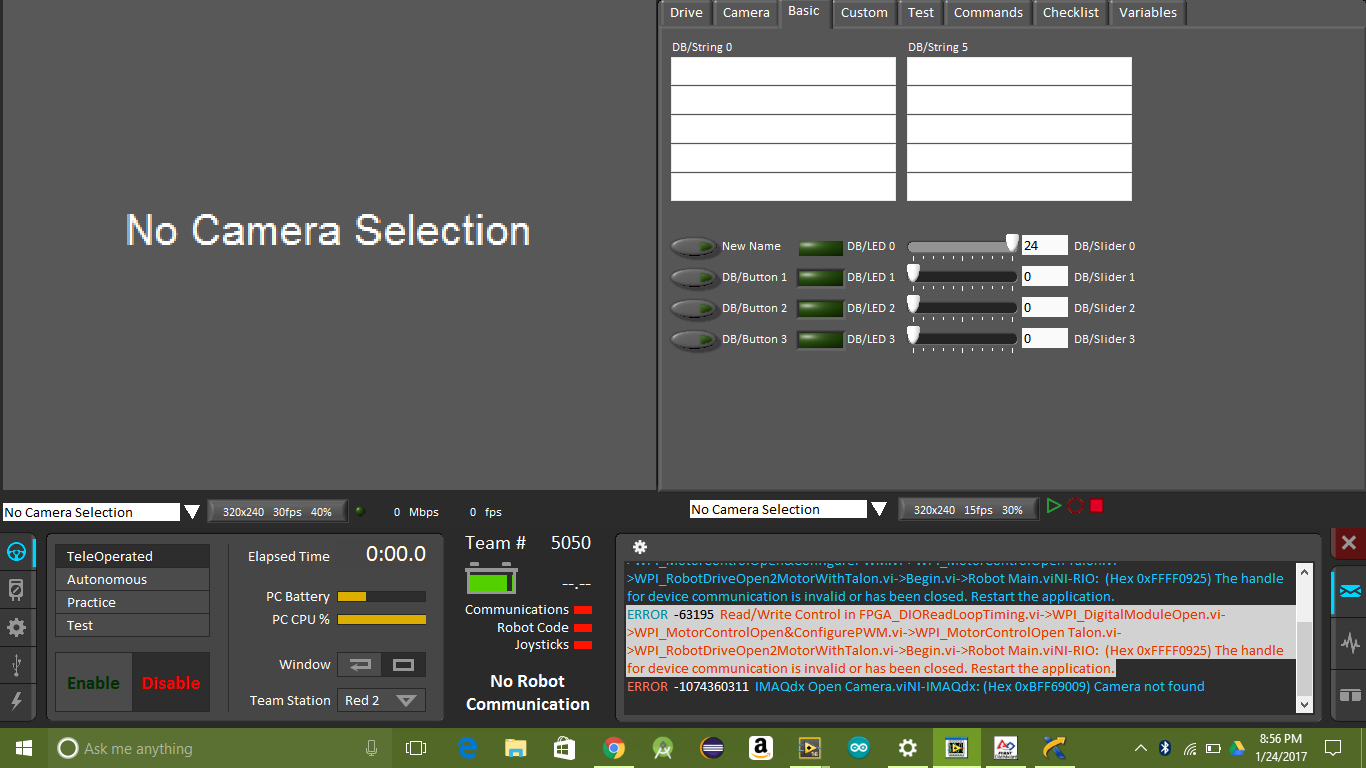

Labview is improperly/not writing pwm/DIO channels. I am currently unable to make any pwm work. It gives me ERROR -63195, and sometimes the driver station will say no robot code even when it is deployed. I have even made a brand new default robot project and it suffers from the error.

The default project worked, and I tried rebuilding my code from scratch. This went fine until I put set outputs into teleop, that caused the first error. So logically I tried removing the motors in the program. It then said that encoders were the problem, so I removed the encoders. This process repeated until I had removed every input/output on the Rio, except for the can bus, which works fine. So I dug in and tried to find the source. The errors led me to the fpga open system.vi. In there it seemed the problem was the address of the Rio. I didn’t take pictures. But I will try to post some soon.

Our team has had the same FPGA and device handling error show up in our driver station and prevent our code from running when we enable. This has been happening on different robots and computers, and even with blank projects, all in the past week. As far as we know, none of the hardware on the robots has changed.
Interestingly, error -63195 is always preceded at the beginning of runtime by error -63192, which says that the RIO resource name is invalid. We checked it with NI MAX, however, and the resource name seems to be fine.
We suspect the problem is in the WPI libraries at the base of LabVIEW or on the robot and know that we didn’t touch that code. Occasionally, rebooting the robot/roboRIO multiple times, clearing object cache, and removing code from the roboRIO has solved the problem, but none of these solution has been consistent–the problem still occurs intermittently.
