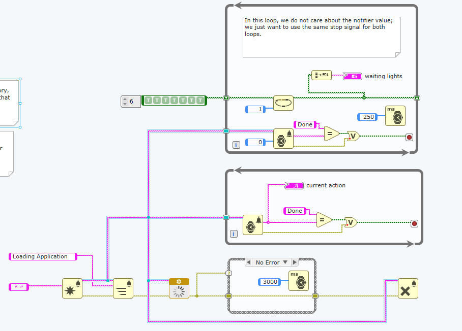

Hi Carlos,
I am the friend that asked for help. I decided to make an account to reply.
My plan was to make an actor framework because, from what I understand, I can create VIs and Sub VIs to control multiple power supplies, oscilloscopes, and other hardware at once. In addition, all of the hardware needs to be able to communicate with each other. I was under the impression that an actor framework would allow me to "create an application that consists of multiple independent tasks that communicate with each other. " This definition, provided to me by LabView, seems to fit my needs from what I know.
Also, it might be important to note that I am using LabVIEW NXG, which provides templates I can use, but I cannot make sense of the code used in each template. This hinders me from modifying the code to fit my needs. I attached the block code provided to me in the actor framework template, but again, I’m not sure what to change to best suite my needs.
thank you once aagin.

What settings do you need to control on the power supplies? If you just need to turn the output on/off, change the voltage and current level, and monitor faults, then I think an actor framework would be too much. An actor framework would be useful if you wanted to remotely change some of the deeper settings on the power supplies (like OCP, OVP, voltage rise rate, etc.).
You could create an individual do-while loop for each power supply, continuously setting the voltage and current while monitoring the output. Or, it could all be in one loop, and the commands for each power supply are in parallel.
I haven’t used LabVIEW NXG, but it doesn’t look too different from the older versions. The LabVIEW youtube channel has a playlist for LabVIEW NXG (Getting Started with LabVIEW NXG - YouTube) and an older one for LabVIEW (Getting Started with LabVIEW - YouTube).
The National Instruments forum also has an Example Programs section (Example Programs - NI Community), so you could always see if something that has been uploaded is useful.
Aside from that, check online to see if there are preexisting LabVIEW VIs for your power supplies. Often, the manufacturers have a set of LabVIEW Drivers on the product page you can download to use, and they usually come with examples.

At one point, i would need to control the OCP, OVP settings. But I am not sure how I could control those settings via an actor framework. I actually don’t know how to turn any of the hardware on and off through LabVIEW…Maybe I should start there. I’ll definitely check out the videos though!
I have downloaded several examples, one of the power supplies I need to connect (CAEN DT1470ET) came with plenty. However, I noticed I cannot seem to find the block code associated with each example. Only the VI Front panel pops up. I do know how to create a front panel, but its the code that I am struggling with. do you know where i can find the block code attached to these examples?
On the Front Panel example you are looking at, is the pulldown choice:
Window → Show Block Diagram
grayed out?
No! I didn’t know that was how you found the block diagrams. Thanks so much!!! I can see all of the code now!!
