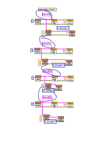

We are using the REV swerve drive module with NEO motors and Spark Max’s and we are having problems with our encoder where the encoder values within periodic tasks aren’t being read from a subVI that’s also within periodic tasks.

Here is our code:
swervebot.zip (3.3 MB)

You commenting and naming convention should be a bit cleaner. You name your steering motors “drive” and your drive motor “motor”. It can be confusing. Are you sure you have the encoder plugged into the correct Spark Max as a result.

In Period, move your get ref num out of the while loops. It is a time consuming activity and you don’t need to get it more than once since it never changes once initialized in begin:
Lastly, in Begin, you say the encoders are attached to the driveFR, driveFL… Spark Max’s:
But in Periodic, you are trying to read from the motorFR, motorFL Spark Max’s.
That is likely why you are not reading anything.

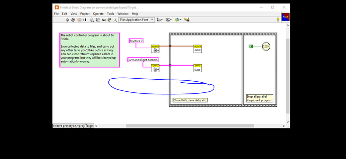

One last thing, you are going to want to close your Spark Max’s in FInish:

@sthump’s already outlined a few issues, but there’s more; you need to select the correct encoder type for one. It’s hard to know what that is since you haven’t said. What type of modules are these? REV MAXSwerve? Something else?
There’s some general code logic problems. Your post processing vi is being called from a while loop that never exits, and is also inside a while loop. That’s not good, as the outer loop will never actually loop because the inner loop will never finish (and outputs will never be sent to your motors). You should remove the while loop in the post processing vi while keeping the code inside (you can do this by right clicking the while loop).

Finish.vi never actually executes under normal operation, so this isn’t really all that useful.
I also noticed in the Begin that they were using the older, depracated versions of the Open and SetRef pointing to not having installed the newest REV.
I have always thought that if you didn’t finish, launch code in debug mode, i.e. hit the run button, and then kept doing that without power cycling the robot you eventually run out of memory or some sort of resource.
It is true, in competition, power cycling solves all of that but in development, without closing devices, something bad eventually happen.
I have never tested it fully but I have always taught my kids it’s just better to close it. If REV gives you a close, I am assuming they found a reason to do so.
CTRE stuff do not have a close, so go figure.
I’m not entirely sure what the behavior is when you hit stop vs. the button to call Finish, but I was either a student or mentor for a LabVIEW team from 2013-2022 and almost always hit stop. We never had a memory issue.
I believe the application’s memory usage is cleared when you hit stop, but like I said, I don’t know for certain. The fact that you can set a refNum of the same name again though implies stuff gets cleared, as that normally throws an error.
Properly setting up Finish and calling it can’t hurt of course, but when a team is struggling to get their drivetrain working and has an event in three days it’s the last thing I’m worried about.
