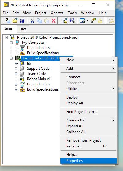

in labview, how do you switch team code numbers. I have an old code from when we were a different number and I would like to download it to our robot with our current team number.
Is there a way to do this? The code is exactly what we want to do and it would save us time in having to re write the code over again.
In Project Manager, click on “Target” and choose Properties from the popup menu.
Then change the team number portion of “roboRIO-xxxx-FRC.local” to your new team number.
