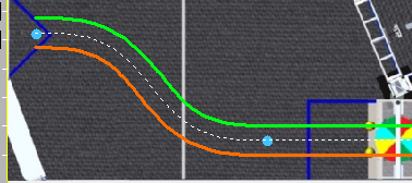

On the Trajectory Creation utility program:

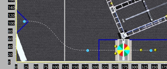

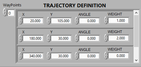

  • The waypoints are entered numerically in the table in the bottom left of the screen. The X, Y, Angle, and Weight are entered. If you want just enter 1 for all the weights and un-select the “Use Weights” button.

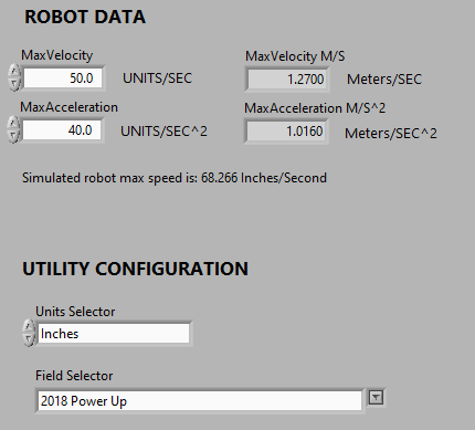

  • The constraint information tries to ensure that the robot speed or acceleration doesn’t exceed what the robot is capable of. They can be turned off, guessed at, or set by using the WPILIB Robot Characterization tool. (I’ve not used the tool, so I can’t tell you much about it.) It suggest the following ---- If you use a differential drive robot – Set the max speed to approx 60% of the real speed of the robot (to start with), Set the max acceleration to be somewhere between 50% to 100% of the maximum speed. Set the wheel base width to be slightly larger, maybe 1.2 times or more, than the width between the left and right wheels. (If you have a differential drive robot, use the differential drive kinematics constraint.). Suggest using the centripetal acceleration constraint and setting it to 50% of what you set the overall acceleration. If these work well, try increasing these to get the robot to go faster.
  • Sorry I don’t have a step by step video or instructions. Basically go through each tab in order. The first time through you won’t have a configuration to read. Skip this to get a default configuration.
Set the robot parameters and pick a field to use.
Set the constraints you want to use. These are all optional. Use the button at the bottom of each constraint to enable/disable each one.
Enter the waypoints. Type over the gray boxes to enter a new row. Right click and select delete to delete a row you don’t want.
Select what kind of spline to use for trajectory creation, if the trajectory is reverse, and whether to use the built in weights or the ones you entered. (I’d start with the built in ones and customize.)

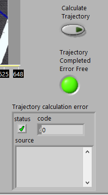

Press the create trajectory button.
Look at the results.
The trajectory line color, width can be changed by clicking on the box next to the legend.
The left and right wheel paths can be turned on if desired.
Change the waypoints as needed and push the button to create an updated trajectory.
