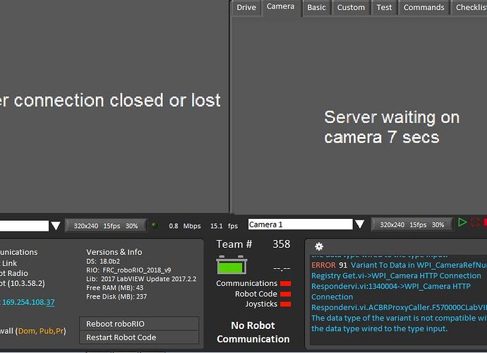

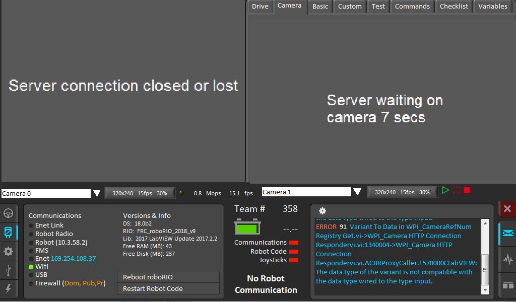

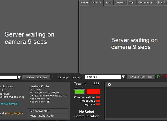

I was a CSA for the offseason CowTown Throwdown. Multiple teams were having issues with their camera when connected to the competition field. We lowered settings to barebones in terms of resolution and compression. We checked firewall and other barriers. We verified that all of their cameras worked in the pits, but not on the competition field. We switched them over to Static IP and all of them started working.
This makes absolutely no sense to me as to why it would be the fix, does anyone have any ideas as to why it is the case?
