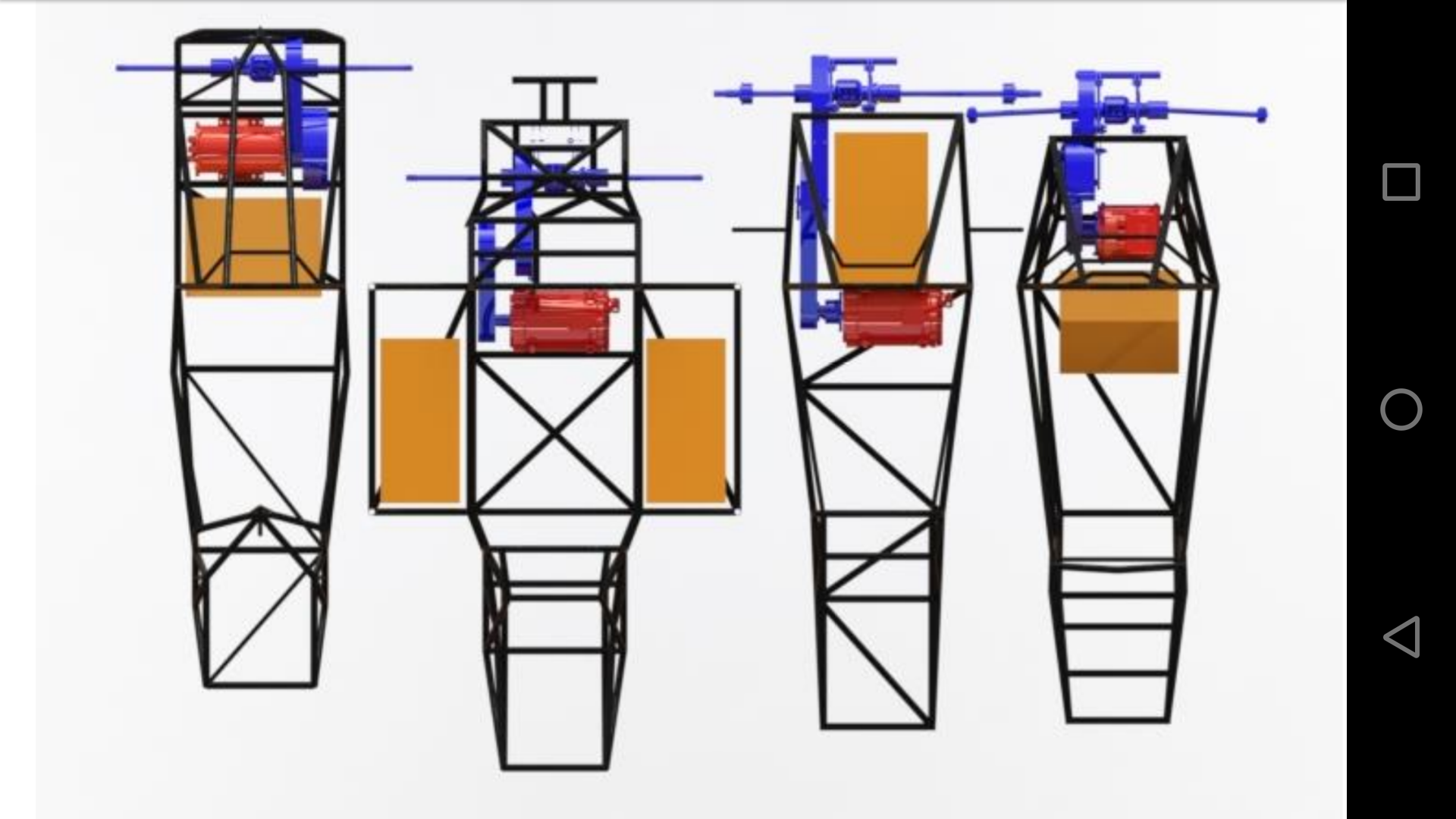

I’ve been working with the same dell Inspiron since 2014, 6gb of ram, Intel i5, and I use it for FSAE and to run ansys, sometimes can take a while but works really well
(Last four cars open at the same time and rendered)

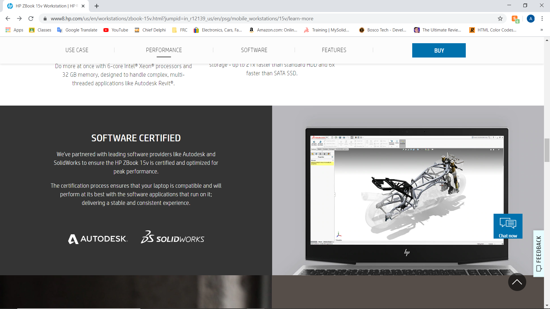

Look no further than the ZBook Workstation " THE MOST AFFORDABLE MOBILE WORKSTATION " (this thing is actually designed for CAD work but it can still handle games and stuff): https://www8.hp.com/us/en/workstations/zbook-15v.html?jumpid=in_r12139_us/en/psg/mobile_workstations/15v/learn-more
