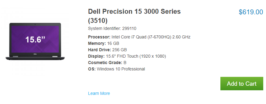

Hey if you are still looking for a laptop and don’t mind a refurbished one. Try this Dell Refurbished Computer Workstations from Dell Refurbished Official Dell Store
Coupon code: LOVE4MOM35
Granted this is only 35% but Dell has done as mush as 45% - 50% for other coupons
