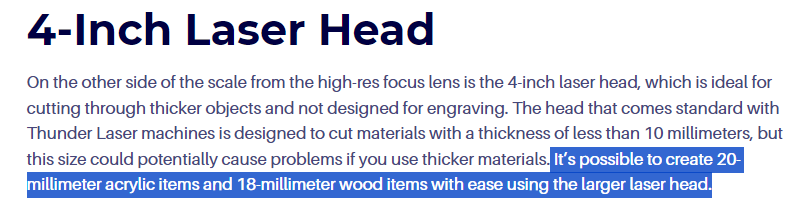

According to Thunder Laser, the machine should be able to cut up to 3/4" nominal plywood with the 4" head:

If your laser truly is 130W you should be able to cut 1/2" baltic birch ply in one pass with no issue. We have a 120W Trotec with 2" focal length and can cut 3/4" thick home depot/lowes baltic birch with no issue (same stuff you’d probably be buying in the bay area). 3/4" is very slow. 1/2" works pretty well.
