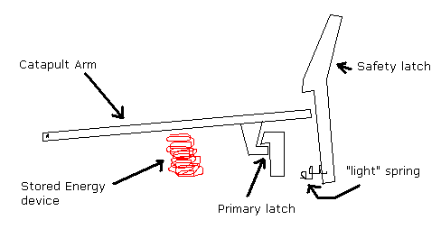

All of you launching teams may want to try to implement some sort of physical failsafe that prevents the catapult from firing unless a ball is present. Maybe something like in the cheesy drawing I attached: A lever that is easy for the ball to push out of the way, but it is otherwise in the way of the catapult arm from firing. This would prevent the catapult from doing a ‘dry fire’ if the main latch fails for some reason.
Also, I think it goes without saying that any edges should be very rounded and preferably most of the hard parts of the catapult mechanism somehow padded such that in the event of it contacting a team member while in motion it doesn’t cause too much damage.

We are taking a different approach. As Gdeaver says, a mechanism that can store energy and quickly release is a dangerous thing, and we felt that relying on interlocks and safety procedures is not adequate. So, we designed our mechanism to behave like any other pneumatic actuated device when the ball is not loaded into it (ie. it moves slowly), and to act like a ball launcher only when the ball is in place.
I think it would be difficult to do this with any mechanism that uses springs.
And any mechanism that has a latch (or two or three or…) that suddenly releases a spring loaded bar is intrinsically dangerous.
