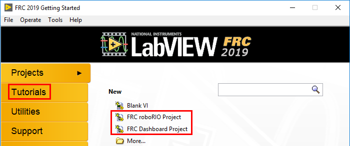

  2. Use the template that comes with LabVIEW for FRC, and the Tutorials tab in the LabVIEW Splash Screen
