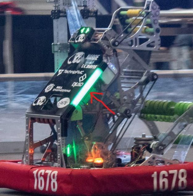

The Blinkin and CANdle are good, but it’s very much extra when you can use a cheap buck-boost converter for power and control them from the rio using the AddressableLED class built into wpilib. You can see a bunch of AddressableLED implementations of varying complexity from teams 1108, 1672 (my team), and 6328.

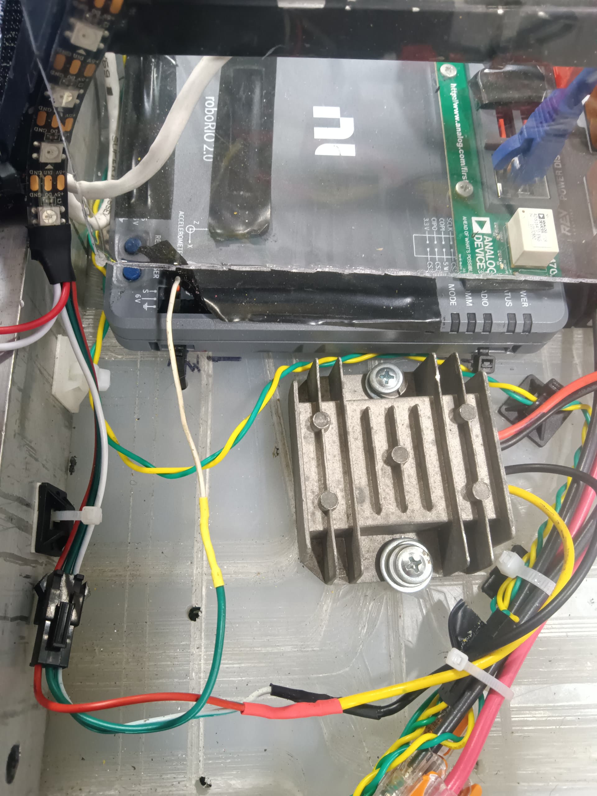

We use a 25W 12v-5v dc converter on a 5A circuit breaker to power our LEDs, but we are only using 60-150 LEDs and I’d probably increase for 300 LEDs. At full brightness, ws2812b can draw 50 mA per LED, so that is 15A max.
Here is most of the connections:
We only powered one end, but it might be helpful to connect power from both sides on longer strips. And another idea would be to split the data signal and run two sides as mirrors.
