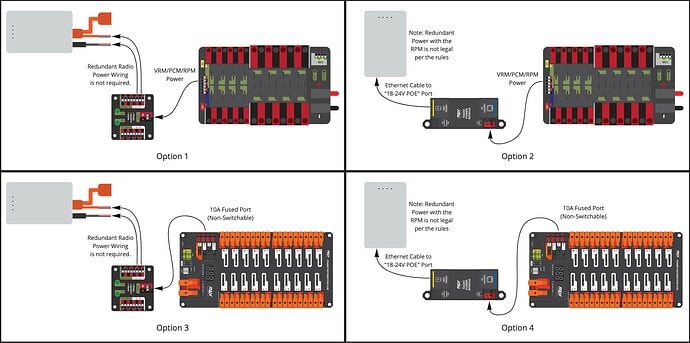

Legal Options for Wiring your Robot Radio in 2022
I threw this together to hopefully help others understand the legal methods to wire their robot radios for this competition season:
Hopefully it helps others given the questions that have come up in the Q&A about legal robot radio wiring.

And the ZebraSwitch is still a legal option to get additional Ethernet ports!
Option 2 and 3 people, I love your energy. What led you to this configuration?

Option 3 is what we are considering switching to. Not having the ability to run redundant power when using the Radio Power Module is a huge downside, and makes the RPM useless imo. I’d love to move away from the crappy POE injector cables, but until we are allowed to use redundant power with the RPM, it may be option 3 for us
Wait so it isn’t legal to vrm to barrel connection and use the rpm?
Thanks for the picture! It’s going into my inspection kit.
It is not and I would not recommend doing it. The VRM is 12 Volt out where as the RPM is 18 Volt.

Nice. The PDH drawing on Rev’s site may confuse people, as it shows the VRM connected to 19 since it is not used to power the radio in the drawing. If the radio is powered by a VRM it needs to be on PDH 20-21 per R617B
