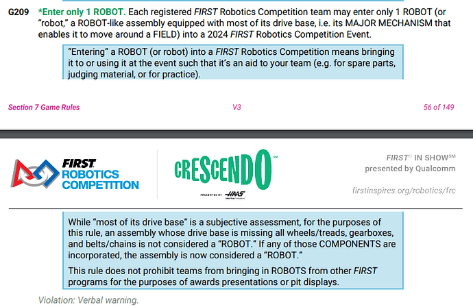

According to this rule a team can bring an entire assembled robot without a drive train to competition. If you make the drivetrains easily switchable, you basically could have two robots. Wondering if others found anything against this rule.

Rule I103 limits you to 150 lbs total of inspected MECHANISMS.
Trying to skirt around the intent of the rules to find edge cases that aren’t violating the letter of the rules is how we end up with controversies and even more rules (and rules that are even more confusing). The name of the rule is ā€œEnter only 1 ROBOTā€ and the blue box clearly spells out the intent of what is being prohibited (entering more than one robot such that it’s an aid to your team).
Also, the parenthetical citing ā€œmost of its drivebaseā€ is defining ā€œrobotā€ vs ā€œROBOTā€ (which is defined in the glossary).
If you want to build interchangeable super-structures or mechanisms for a single robot, that is allowed - and the rules covering it can be found in Section 9, specifically I103, I104, and I105.

I think @Lil_Lavery got it right. The spirit of the rule goes against what you’re suggesting, and I wouldn’t try to push those limits.
If I had to try to use the letter of the rule to try and explain the illegality, I’d say that when you affix mechanisms to a drive train, you now have a ROBOT. The rule doesn’t say ā€œ1 robot at a time.ā€ It says ā€œ1 ROBOT.ā€ If you had a second ROBOT in the parking lot and swapped it out, that wouldn’t be allowed because, during the course of the event, your team would have entered two ROBOTS. For the same reason, you can’t make a ā€œrobotā€ a ROBOT and then reverse it.
But the bottom line is that the rule is trying to discourage teams from doing what you describe, but rules are hard to write in ways that aren’t overly burdensome for the rule followers.

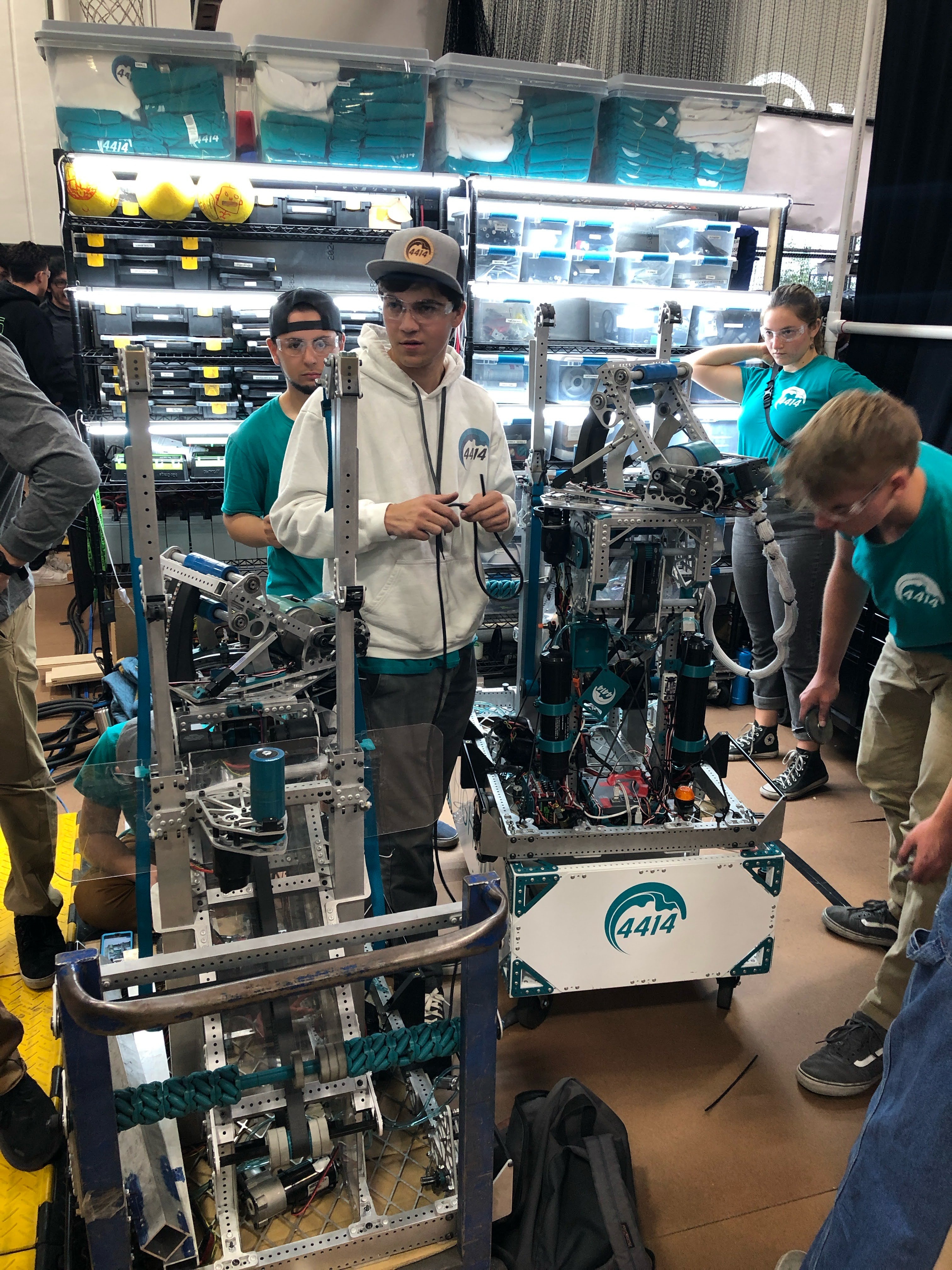

We’ve brought our practice ā€œNOT-a-robotā€ to events several times since the rule was introduced in 2020.
Completely legal, mostly pointless.
It was primarily used to talk about and show off the robot in the pit.
We’ve had some trouble with non-lead inspectors but any concerns were immediately dismissed by the LRI.
I have been the LRI for both the 3467 and 4414 examples. I can say I am not happy with the ā€œlarge piles of spare partsā€ but I agreed with the conclusion that they are valid. I do appreciate the clarification of the rules, from previous versions. I agree with JJ that it is not worth it mostly. I think it is better than teams instinct to sneak out to the parking lot (or the local shop) and raid the practice bot for spares. Definitely a rule violation that it is hard to monitor.

Your statement isn’t logically consistent. Something without a drivetrain, by FIRST’s definition, is not a robot. Thus, what you are describing is not a second robot.
Unlike some words that FIRST leaves to interpretation and one has to default to Webster’s dictionary for answers, this one is defined.
You legally can not bring two robots to an event.

Ever since this rule came out in 2020 we’ve found it pretty poorly written and we honestly get a kick outta bringing our not-a-robot to events.

Over the 2023 season, our torn down practice robot helped keep more teams on the field than our own. I don’t think it ever helped keep 3467’s competition robot moving by providing a spare. On more than one occasion parts from its swerve drive ended up on another team’s robot to keep them in the game.
Always worth it to keep robots moving even if it resulted in more work for us.
